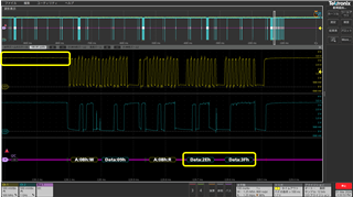

Dear Sirs and Madams,
We are considering the bp20z75-V180.

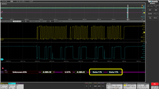

It has been confirmed that when reading data from the bp20z75-V180 used inside the battery during SMBus communication immediately after clock stretching occurs, the fixed value 0x17 is read.
Is there a reason why 0x17 is sent as a fixed value?
For example, could you please let us know if there is any information on whether 0x17 is always read as an undefined value?
I cannot get the datasheet or TRM for the bp20z75-V180 from your website, so I would like to know about this phenomenon.
