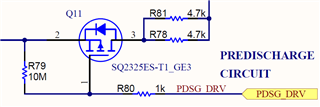

Dear Experts,
I would like to ask if it is possible to lower the pullup resistance of the predischarge gate to around 100kOhm instead of the 10MOhm specified/recommended?
I show you which one I mean (R79):
Is 10MOhm recommended because the current pulldown capability of predischage pin is only 30uA according to the datasheet, here?
My motivation to lower this R79 resistance to 100kOhm is that a smaller value means a stronger pullup (switch off state)
and less susceptible to unwanted turn on for example.
Thanks and regards,
