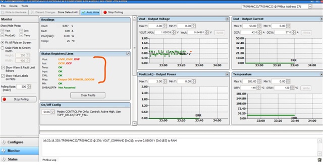

We are programming the TPSM846C23 regulator to 0.85V. We notice the VOUT value fluctuates from the programmed value and regulator goes into OFF state.
We are using 'fusion digital power designer' application for programming.
OCF & OCV faults are observed.
Please let us know if we need to adjust any special registers.
F_sw=350kHz, Compensation network, 1k & 1000pF.
Voltage input = 12V, V_out=0.85V@ 35A

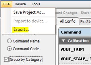

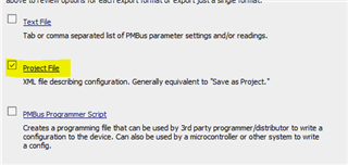

    Can you attach the schematic? I'm sensing it could be related to components/stability.
    Also can you attach the XML file to see the commands side? This can be done by going to: Fusion digital power designer > click to configure device > file > export... > ProjectFile > export all checked formats

  • Hi Eileen,
    In continuation from the above, we are facing issue as the load value is increased. The device trips at 7A.
    We connected the external DC electronic load to the regulator output. The current limits are at 37A (for warning) and 42A for fault as seen from the 'fusion' G UI.
    Are there any specific registers that need to be programmed further?

  • Hi Eileen,
    We tried with 650KHz - but the voltage itself not stable. Hence, reverted to 1MHz only.
    TON_rise also tried with 72, but no improvement. The VR trips at 7A. We don't see any current overshoot of output current but the OCF& OCW messages are shown in the GUI.
    Here with please find the .xml file. Please review and let us know.
