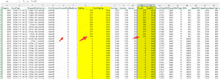

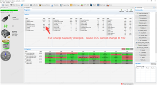

①BQ34Z100 I have learned it successfully, but when working with the charging chip, the coulometer SOC does not display 100 after the battery is full. At this time, if the coulometer is reset, the SOC will change to 100。My Settings are as follows.
In the final stage of charging, the average battery voltage >3650-300, average current <800ma,At the same time, the accumulated charge amount within 40s > 25/256*3600;
Why didn't the coulometer jump to 100?
The FC set=100 was set at the beginning of the battery learning, and the battery learning was successful, and now I find that FC=-1, the primary charge termination algorithm will be used involving Tapper Current,Min Taper Capacity, Taper Voltage, and Current Window. It doesn't matter if I modify the FC SET directly in the already successful file?
    1) Can you send a log file of the SOC jump. I would verify design capacity is correct.
    2) You can adjust FC set%.
    Evan

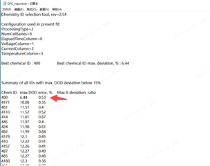

  • I use 8 3.2V/3.8AH batteries in series. The AFE chip uses BQ76952, the charging chip bq25756, and the coulometer chip BQ34Z100-R2.
    The maximum voltage of the battery is 3.65V. In the final stage of charging, AFE often has overvoltage protection, so I turned off the AFE overvoltage protection in all third experiments,
    The first experiment, BQ34Z100R2 FC=-1, CHARGE voltage=3650,charging chip output voltage 27.15V,current 1.9A

    54,2024-06-15 10:47:49,216.679,0x0202,0x0004,70,1,2690,3895,3623,52,197,29.5,65535,367,8,1,8,829,20,33.8,0,100,3450,1900,1226,0x09D9,0x0100,0x4400,0,2,0,1283,2690,3895,203,-78,2,5248,0,-78,2,949,SUCCESS
    The above is my test. The charging chip I used will automatically stop charging when the current is lower than 250ma. Is it related to this? I need you to look at my log.

    Question. ①After complete discharge and charging, FC becomes 1 after full charge.
    but it can be found from the log that after discharge, SOC jumps to 100 when charging starts. The reason is that FULL Charge Capacity jumps. I want to know the reason, and this problem has been mentioned before, link as follows. I wonder if this has anything to do with me not locking parameters?

    Its good to see you have your GPCCHEM report, Chem 400 is an ok match, typically we recommend a dod% error of 3% or less but this should not be a major issue.
    It is also good to hear you have completed a learning cycle, from the .gg file you sent it update status appears to be 2, it should be 6 after a successful learning cycle, can you verify that you have gotten a Qmax update and your ra tables have updated. This could be your issue.

    2)From my discharge and charge log, you can see that after discharge, SOC=0, but when I started charging, SOC jumped to 100 instead of going from 0 to 100. I wonder if it has something to do with the fact that I didn't lock the battery meter chip parameters?
    7206.log

  • My steps are as follows:
    ① Burn the successful learning file and save.
    ②Calibrate the voltage and current.
    ③Sealed BQ34Z100.
    Unfortunately, the FULL CHARGE CAPACITY jumps again, I told you yesterday that the SOC will jump to 100 when charging, in fact, the essence of the reason is that the FULL CHARGE CAPACITY changes. Below is my picture and log.

    Thanks for the log file, so the issue is that FCC is dropping to 0 when the charging begins. And from that point FCC = RC resulting in 100% SOC. This is strange behavior; however, can you disable smoothing, and change load mode to 1 and log the discharge as you have done.
    Evan
  • Unfortunately. I changed load mode to 1 but Remain Capacity still rise when charge.

    After reviewing our entire thread, this error is most likely due to 6.44% Dod error in the chemid match you obtained. You can contact your local Ti office about sending in cells to get characterized in our labs.
    Evan
