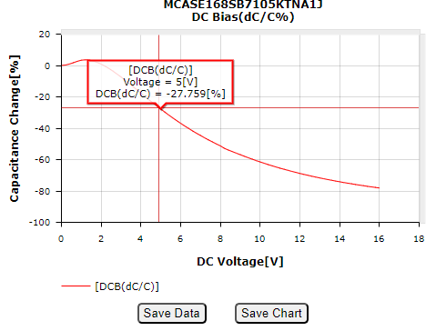

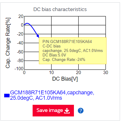

Our customer is designing schematics using LM63635-Q1.
As of now, they plan to use following capacitor at VCC cap.
GCM188R71E105KA64
This capacitor's rated capacitance is 1uF and it is same as EVM's cap.
But DC bias performance is little bad(approx.10%) rather than EVM.
Then, could they use this capacitor or should they use better performance capacitor as same as EVM?
