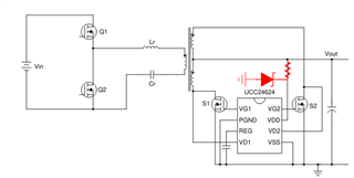

UCC24624: How to provide power to Vdd with LLC output of 60V?
Part Number: UCC24624
Hi Team,
We want to use UCC24624 in LLC secondary side having 60V output to drive Vdd of synchronous rectifier. But, the Vdd pin has limitation. Can we drive using a zener in series with a resistor which has lower zener voltage (around 16 to 18V) than the clamp (24V) which is inside the UCC24624?
