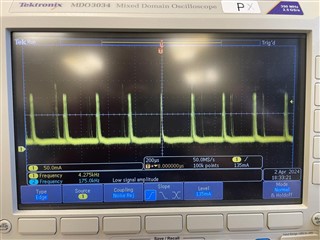

When I measure the input current, I see on scope current pulses every 200usec. and 100-140mA amplitude (please see attached scope picture).
So, my question is why I have these current pulses and how i can remove them.

    It is because device working with PFM mode to save power. if you do not care about the efficiency, you can just connect PS_SYNC pin to GND to set FPWM mode for device.

    You are right, it is cause because PFM mode. But if I do care about the efficiency, how can I remove or reduce this effect?

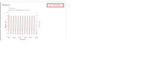

    Also, when I simulate this component with "webench power designer" i didn't saw any current spiks (Maybe you can advise me where I can see this).

    As you seen, frequancy of  these spikes are realy low,  which makes them hard to handle with. Ideally, you can place a double pole at low frequency(may be one tenth  the frequency of your spikes). Another thing to remind is that actual frequency of spikes change with load.
    And another question please, during the development stage how I can expect this effect?
    They are nromal behavior for a device working in PFM mode, i think just make sure the peak current will not out of capability of your battery is good.
    For Webench design, you can see the current spikes by adding Iin waveforms.
