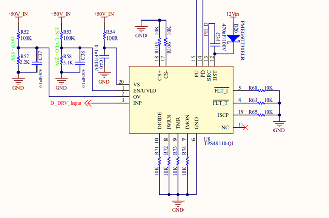

TPS4811-Q1: Not Getting PU & PD Signal
Part Number: TPS4811-Q1
I am using TPS4811 for mosfet driving.
When i am applying the signal at INP, Not getting signal at PU or PD.
I had done simulation on PSPICE TI, Its working fine there but not working on by board
Note :- I am not using current sensing so i made some changes into the circuit which is mention below
Grounded the pins using 10K resistor (Diode, IWAR, TMR, IMON, ISCP, CS+, CS-, FLT_T, FLT_I)
1. Designed Schematic
2. Simulated Schematic
