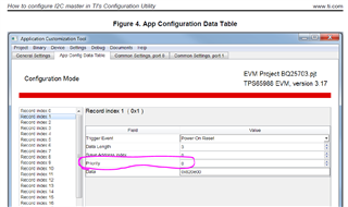

I try to control DP receiver from TPS65987DDK I2C.
I'm making configuration by Application Customization Tool v6.1.4 referred to the following document.
Using I2C Master in TPS65987D and TPS65988 PD Controllers
But I cannot find priority bit setting on the tool. How can I assign the record priority?
This is the screen shot from the document.

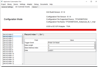

This is the window of Application Customization Tool v6.1.4.
  • Hi Eugene,
    The Priority bit was removed in later GUIs.
    Looking at the app note you shared, all of the I2C controller events have a priority of 0, so you should have no issues using the v6.1.4 GUI even though the Priority field is removed.
    If you are concerned with the order that the events occur in, they should occur from lowest Record Index to highest, so you can configure their order that way.
