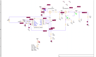

2. We have series resistors on all of our capacitors that touch the input rail, but we see the IC get damaged upon plug-in. It appears there is a current path through either the C/A pins to the charge pump cap hooked up to C67. See the image attached

  • I will also add, that I've confirmed no voltage on the output side (V_SYSTEM), thus it is inrush solely due to the IC and input side.

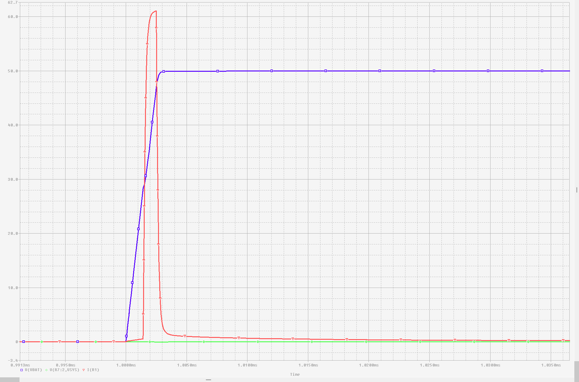

    We've isolated all input capacitors and still see significant inrush current. I have also simulated this using TI's spice model and am seeing significant inrush, though in a slightly different outcome.
    When Vinput to the LM74810 is < 25V I see expected inrush of just the capacitors, however, when I increase voltage beyond 25V and particularly at 50V I start to see voltage show up on the output of my Mosfet which causes inrush on the order of 60A. Can you confirm if you see this behavior in your simulations? Is there an issue with the models, or is this real?
    In the Simulation plot:
    Blue = Input Voltage
    Red = Input Current
    Green = Vgs of the blocking FET U2 | Showingthe FET is staying off but there is ~20V on the source and gate of the FET

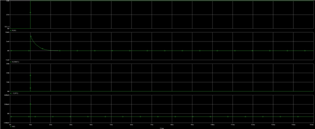

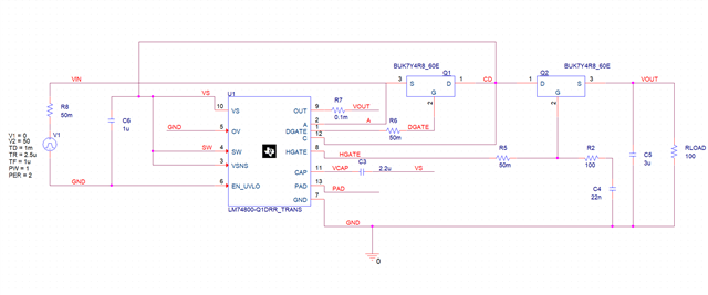

  • Hi Peter,
    I simulated same design as yours. Please see if there is any difference.
    I don't see my VOUT rising. With EN low, VOUT can't go high. There is no significant leakage that can charge VOUT to such high level in real use case as well.
    Possibly your chosen FETs have some leakage modelled. Can you change the FETs and try again?
