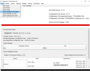

    If this is an issue with moving projects from DK to DH.
    I'm not sure if you have already tried this, but can you try taking your working project, and using the "Import Settings From Project" option in the GUI?
    Make a new project, selecting the part you want the project for.
    With the project open, select Project again, and the "Import Settings..." option should appear.
    Select the older project you want to import settings from.

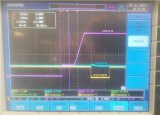

    Here is what I believe is currently happening in our system in the use case. Below are experiments that I have made using our EVK (DK version, we have DH version parts... more confusion)
    • 1. a and b. All OK, the system is powers from Port A.
    • 2.
      • a. Negotiate Maximum power: This works properly- on the EVK the VBUSB LED is bright, the SYS continues to receive 5V from Port A
      • b. Disconnect Port A sink path:
        • Executing a DeadBattery Clear Flag command at this time causes SYS PWR and VBUS-B to briefly turn off.
        • VBUS-B comes back on , negotiated to max power and SYS PWR comes back on, but is still still connected to VBUS-A (should be connected to VBUS-B)
    The firmware on our product executes a DBfg command immediately after power up. When this is done the results are the following on the EVK:
    • 1. a and b  Connect Port A to laptop works correctly (using a USB A to USB C cable).  The system is powered from Port A.
    • 2
      • SYS PWR does not switch over to Port B

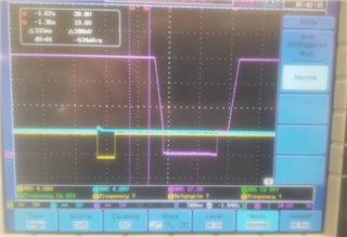

    Looking at our product, power is taqken properly from port A.  When port B is connected the following occurs:
    Every 10 seconds this occurs:
    When SYS PWR goes to gnd, the product resets.

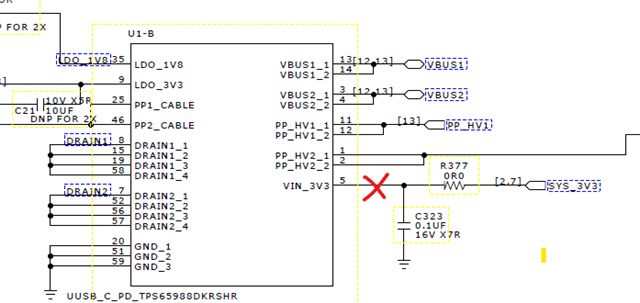

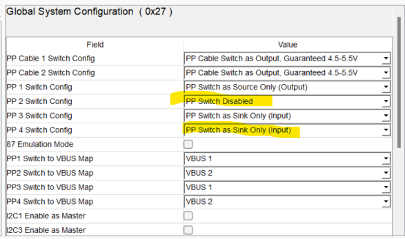

  • Hi Chris,
    Thankfully we have the circuits for using an external switch for Port B on our board.  We populated this, adjusted the .prj as follows:
    We are able to achieve seemless sink switching from Port A to B using external switches to sink on both ports.  We also needed to disconnect VIN_3V3 from the system 3.3V.
    By doing this, the TPS65988 is able to remain powered up as long as there is VBUS on either of the ports.  With VIN_3V3 connected, if the system supply collapses, the TPS65988  resets and the deadbattery flag gets reset.  With VIN_3V3 disconnected, during the dead time (1ms) when both Port A and Port B switches are not on, the TPS6988 remains powered.  We only use the LDO_3V3 to power the flash, so I believe that we should be OK with running the TPS65988  and flash on just the LDO supply.
    I will set this issue as resolved.  We still have issues with sourcing on Port A, but I will address this in a different thread.
  • Hi David,
    Perfect, sorry for the delays in communication.
    That was actually the issue I was running into, but didn't realize you had both external paths populated. During testing with the EVK, I was able to get the solution working if both sink paths were internal, or if they were both external, but the specific orientation you had that was one of each ran into power cycling issues when switching between sinking from the different ports when sources were added/removed.
    I have not been able to figure out ways to get your original system to work(one internal, one external sink path) but it sounds like you have a way to get it working.
