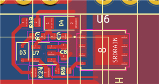

Based on the evaluation board schematic and layout we have designed the schematic and layout for our custom board. The mosfet we are using is BSC061N08NS5ATMA1. What we are experiencing is that the SR starts and very soon switches off. After reading the forum we noticed that unless the load is added (to make drop of Id X Rdson of 10mV) we added 2A of load (BSC061N08NS5ATMA1 has Rdson of 6 mOhm) but it still gives us the same behavior.
Can someone help?

    I reviewed your layout and you have long trace to the VD pin of the UCC24612 and the FET's drain.  There are also long traces between the snubber R49 and C24.  Traces add roughly 10 nH of inductance per inch.  There could be ringing causing the issues across the Vd and Vs pin of the UCC24612.
    The first thing you might want to do is study VD, VS, VDD with an oscilloscope to make sure:
    1. VDD is properly biased.
    2. There is not excessive ringing across the VD and VS pins.
    If there is excessive ringing across the VD and VS pin you can use R49 and C24 to snub it.  There is information on how to setup the snubber in the UCC24612 data sheet.
    https://www.ti.com/lit/gpn/ucc24612
    If snubbing does not work you may have to modify the layout.  The data sheet and EVM give layout guidelines and examples that you can use to improve the layout in your design.  The following link will get you to the EVM's user guide that contains information regarding the EVMs layout.
    https://www.ti.com/lit/pdf/sluubp3
