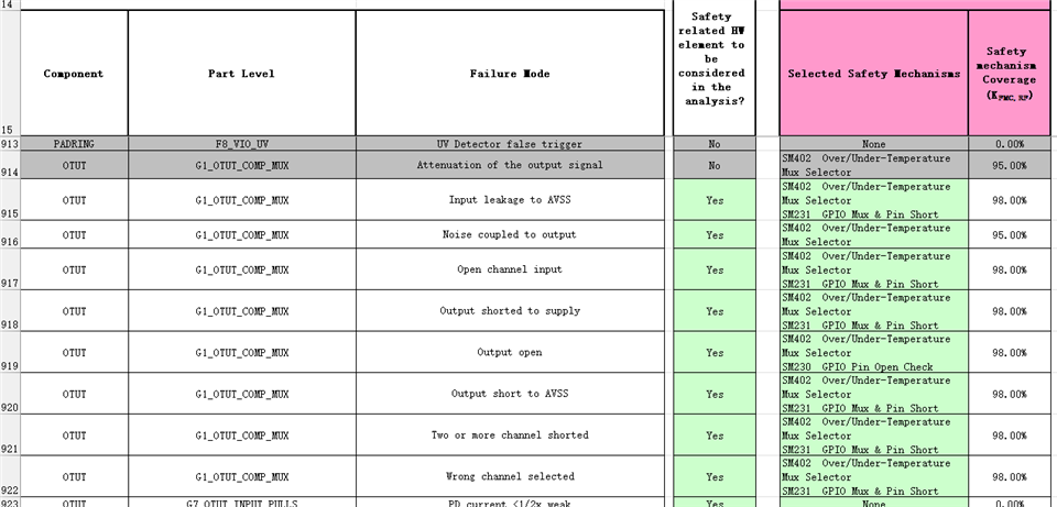

But in FMEDA, they have been used to cover some failure modes, for example SM402:
So I want to know the meaning of "This diagnostic is not required to meet the ASIL-B goal for the secondary protectors"
Why these diagnostic is not required to meet the ASIL-B goal for the secondary protectors and how to understand the note?

  • Hi Benjamin:
    Thank you for your answers.
    It's very clear for me, but I still have a question need your clasification.
    If I cut the SM402 and SM302 for an ASIL B system , then in the FMEDA calculation tool, these failure modes shown in following picture has no corresponding safety mechanisms to cover, is it OK for met ASIL B requirement? How do I deal with these failure modes?
    Thank you.
  • Zizhen,
    After removing safety mechanisms you want to remove, then you will have faults that are not covered. The fault metrics in the "Totals-ISO26262" tab should be used to determine whether you meet your target ASIL rating (ASIL B in this case). It is okay to leave faults uncovered, as long as the "Totals-ISO26262" tab meets your target fault metrics.
