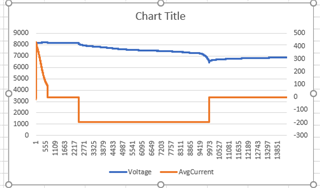

I have tried multiple times to complete the learning cycle with the battery pack manager bq40z80 and it always fails after the charging cycle.
Discharging and relaxing afterwards worked properly.
But after the charging cycle the battery pack which contains of two cells goes into the overcharging protection (the "OC"-bit is set) and the FC bit does not set.
I have also attached the csv files that tracked the discharging and charging process.
The chemical identification has been conducted properly before attempting the learning cycle.
Thanks for your help in advance,
Dino
learning_cycle_log_2024_06_03.csvlearning_cycle_log_2024_06_04.csv

    It somehow did not work properly after it charged fully.
    The Full Charge was detected and [FC] bit was set.
    But afterwards it did not work properly.
    I will attach the .csv files from logging.
    learning_cycle_2024_06_24.csvlearning_cycle_2024_06_25.csvlearning_cycle_2024_06_26.csv
    Thanks in advande.
    Best, Dino

    I noticed towards the end of the final discharge that the RDIS bit gets set in the IT Status Register. This indicates to me that the ChemID that you are using was not matched correctly. How did you obtain the ChemID, did you use the GPCCHEM tool?
    Nick Richards

  • Hello Dino,
    Thank you for sending the datasheet for the battery you are using. It looks like the charging was done incorrectly according to the datasheet for the battery. The charging voltage of one battery is 4.2V so for two batteries in series the charging voltage should be 8.4V. According to the log you provided, the voltage only goes up to 8200mV. Please complete the test again, but make sure to constant current charge until 8.4V and then constant voltage charge.
