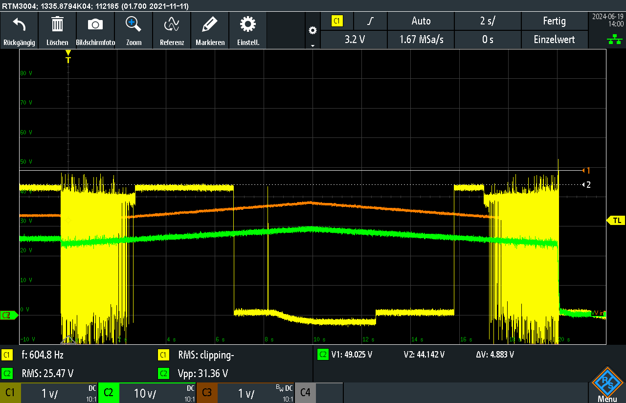

  • Hi Harry,
    thank's for your quick answer.
    Yellow: Gate-Source on TOP-FET
    Green: input voltage:
    Orange: PIN13 at LM5123
    Entering bypass mode is fine. But if the input voltage continues to rise, there is a point at which the gate-source voltage drops to 0V. When the input voltage drops again, the gate-source voltage rises to about 4V and the bypass mode is activated again. If the input voltage drops further, normal mode is activated.
    So what is the reason for the TOP-FET switching off? VCC is stable at this point.
    There is a 0.1uF capacitor at VOUT near the IC.
    Best regards
    Ludwig
  • Hello Ludwig,
    There must be some kind of noise (very short negative spikes) which is causing this.
    The noise will only have an influence when the input voltage is in a range where these distortions will reach the falling threshold of the OVP comparator.
    When the input voltage is higher the spikes may be small enough, so that they will no longer have an impact.
    Again:
    The LM5123 will needs to see 40µs of continuous OVP status.
    If there is any single distortion during that time it will re-start again.
    That thin yellow spike shows that the controller kept trying to get into bypass mode and at that point in time it did manage for a short period of time, before the next distortion/reset came in.
    From my own measurements, I can tell that such negative spikes may be very short (shorter than the sampling rate), so that it is hard to catch them with any oscilloscope.
    I had tried to capture them on the LM5123 EVM when looking for an explanation for a different case, where in DE mode the upper FET may get turned off earlier than expected.
    Best regards
    Harry
