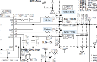

Customer is going to use LM5145 with Toshiba's FET TK8R2E06PL. They want to switch the FET as soft as possible.
Could you estimate the maximum gate resistance for this combination?

  • Eric-san,
    Customer increased the gate resistor gradually and, the overshoot and ringing were gone by 10ohm.
    If there is no issue about MOSFET temperature, they can go with 10ohm? Or, should they reduce it less than 5ohm and add a series resistor at Cbst, or so?
    BTW, they should not add the gate resistor for low side FET, right?
  • Eric-san,
    I confirmed their circuitry little more.
    He put 10ohm for both High side and Low side and, put 2.2ohm as Rbst.
    The package of TK8R2E06PL is TO-220 so, he doesn't have thermal issue.
    Is there any concern?
  • Hello Atsushi
    • If there is no issue about MOSFET temperature, they can go with 10ohm? ==>You also have to check if the dead-time is enough or not.
    • Should they reduce it less than 5ohm and add a series resistor at Cbst, ==> Nope, gate resistor is better than the BST resistor.
    • They should not add the gate resistor for low side FET, right ==> You don't need the gate resistor on the low-side if the HO-off to LO- on dead-time is enough.
