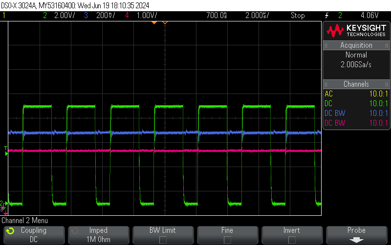

At 40V in and 40mA load, everything looks fine. CH2 is GDRV, CH3 is FB, CH4 is COMP

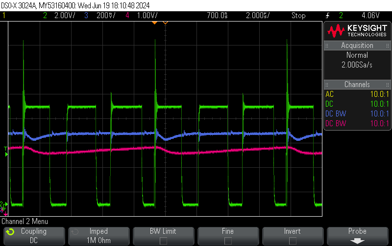

At 50mA ringing appears on GDRV and there is an FB anomaly the following on-period. Output voltage is dropping slightly.

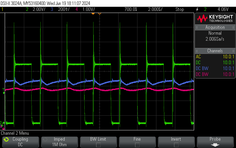

At 90mA output the situation has stabilized. All cycles have the GDRV ringing and all cycles have the FB anomaly.
It looks to me like there is causality between the GDRV ringing and the FB anomaly. From the device block diagram it appears that the only two possible sources of the FB anomaly is SS and VRef. SS is stable as a rock, leaving Vref as the culprit. Any ideas for a cure? Is this merely a layout issue or is there something more sinister going on?
