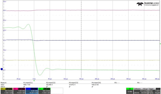

  • Hello Christian,
    of course no problem I had already measured the points and saw no abnormalities.
    The first picture shows the entire interruption, in the second picture I zoomed in on the edge.
    CH 1 is the input voltage
    CH2 is ACOK
    CH3 is the battery voltage
    CH4 is the charging current
    Zoom:

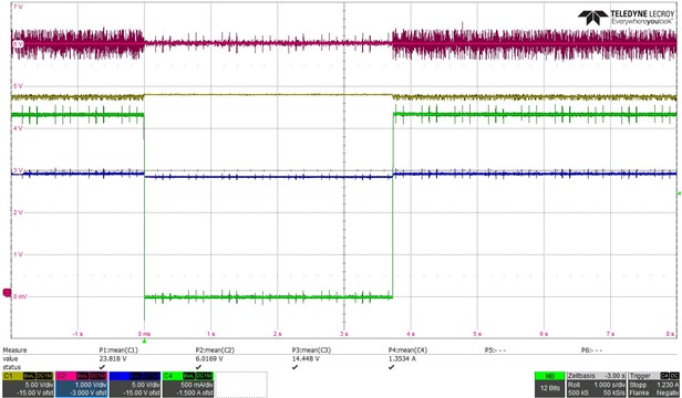

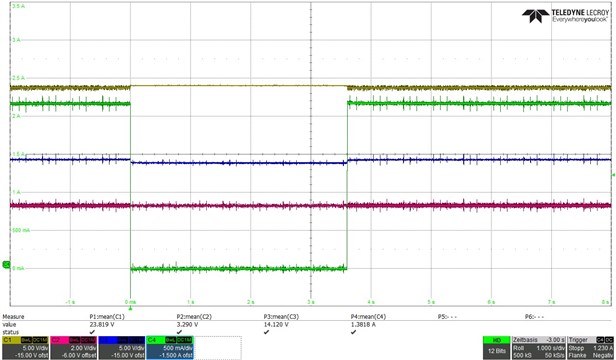

    Here I have once again converted the CH2 to the Vregn voltage.
    CH2 6V Vregn
    Zoom:

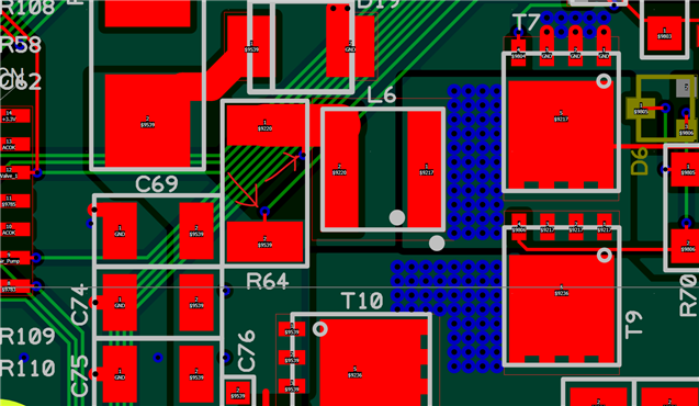

  • Hello Christian,
    The capacitors between SRN and SRP are perhaps a little badly drawn. These are located behind the shunt. The shunt has two separate lines for the measurement which are not in the current path. Here is a section of the layout:
    What exactly do you mean by how +Vsys is connected to the system? Behind the fuse are various loads that can be switched and the 3.3V voltage regulator.

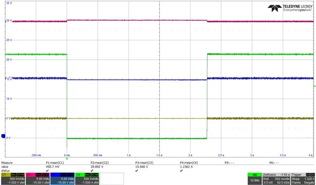

  • Hello Christian,
    here is another measurement with the voltages .
    I have triggered on current channel 4 so that we can see the correct time.
    CH1 shows ILIM.
    CH2 shows the SRN signal
    CH3 shows the ACDRV signal at 24V input voltage
    CH4 shows the charging current of the battery
    Best Regards
    Philipp
  • Hello Philipp,
    The SRN voltage is 29.892V-30.048V? Is this correct?
    It looks like the device is going into BATOVP mode.

  • Hello Christian,
    Sorry, I made a mistake yesterday with CH2 and CH3...
    CH2 is the ACDRV voltage at an input voltage of 24V
    CH3 is the battery voltage measured at the SRN pin.
    Then the battery voltage is not exceeded. I suspect that at 30V the battery's BMS would also stop charging immediately.

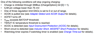

  • Hello Philipp,
    These are the conditions to stop charging:
    According to your test the device is not running into any of these faults.The last thing to check is the TSHUT IC temperature threshold is reached. Can you measure the temperature of the IC?
