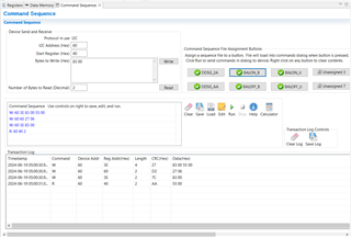

We have now connected this BMS to a cell simulator, and are using an EV2400 and BQstudio for further debugging. Upon applying the CB_ACTIVE_CELLS() functions, the BQstudio does acknowledge the command.
However, we still fail to measure any voltage across the balance resistors, any Vgs voltage on the balancing FETs, nor any increase in power consumption. It appears the AFEs are acknowledging the balance command, but simply not applying it.

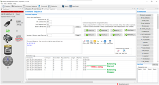

    If you continue reading again, does it report that balancing stopped?
    If only a single die is experiencing an issue, I would suggest to do an ABA swap with a good board and see if the problem follows the IC or it is based on the board.
    Typically balancing would only stop when there is a fault condition is present (with the exception of OV).
    Mind also sharing your .gg.csv file so I can review all the cell balancing settings?

    It reports balancing has stopped, within 1 second of the initial command. I've added a screenshot to illustrate:
