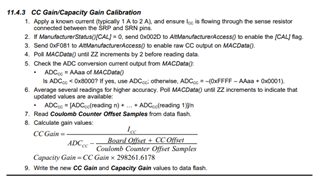

In the TRM for BQ78Z100, page 54 says:
Capacity Gain = CC Gain x 298261.6178
On page 88, it gives the default values.  The default values are calculated using a multiplier of 29826.1.   So the value for Capacity Gain is 10 times less than would be calculated with the original formula.
What is the correct value to use for the calculation?
