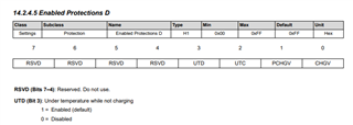

I'm using BQ4050 in my BMS design. I'm facing issue on Toggling the DSG FET.
When i read all the registers, Safety Status (UTD) is High which indicates under temperature Discharge. I'm facing this issue even after disabling TS1, TS2, TS3, TS4, TSint.
Also in my Hardware I have connected the pins TS1, TS2, TS3, TS4, PTC, PTCEN to VSS.
Please let me know how to disable this UTD feature. I have also attached snips of registers and Bit Registers for your Reference.
