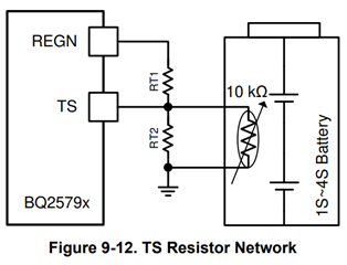

    I think we are getting closer. We poked and prodded the IC yesterday and discovered few things:
    Apparently the ADC (on all channels) is not enabled by default. We have enabled it and it now measures all voltages, albeit not really accurately.
    We tinkered around with the TS pin and finally disabled the thermal check and now it charges from USB. Hence our resistor combination must have been wrong. I still want to see if it charges from the solar panel. Waiting on sun to poke its head from behind the clouds.
    So far so good.
    One question though - since it seems to have been not charging because of the TS input, how come none of the fault registers indicated thermal problem - too cold or too hot?
    David
  • Hi David,
    Looking at your schematic, are you using the thermistor of the battery? Please refer to figure 9-12 from the datasheet for reference.
    Jibin
