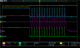

Experimental phenomenon:
When the battery input drops near to 3.3V and keep this voltage near 5S (the power input for TPS6593-Q1 will follow the primary power output, so the voltage is near 3.2V) , then PMIC TPS6593-Q1 will go to safe recovery state after RECOV_CNT_THR reach to 15 times and then shut down all power output.
The test wave is as below: (Channel 1: VCCA of TPS6593; Channel 2: GPIO4 of TPS6593)
My question:
1. Why does the PMIC TPS6593 go to safe recovery state? Is this because the power input voltage to TPS6593 has little voltage dropping?
2. Can we modify some registers setting in TPS6593 side by I2C in order to prevent this behavior?

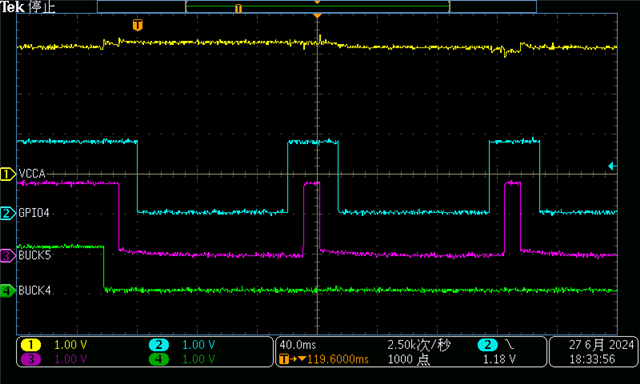

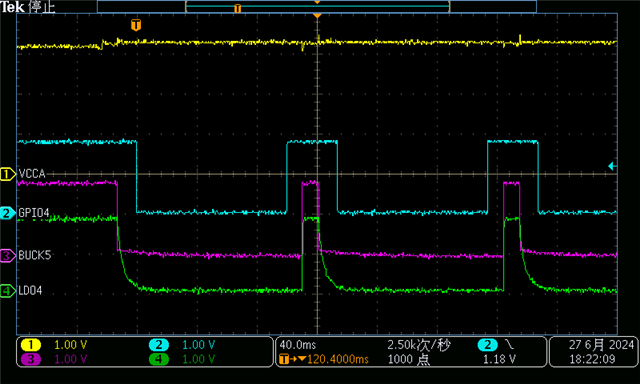

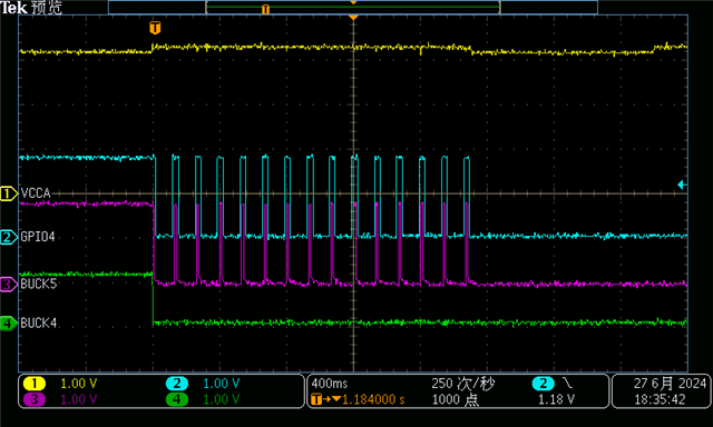

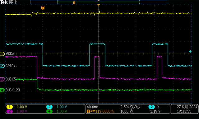

  • Hello Nicholas,
    I got your point, thanks for your finds.
    Please view the detail test wave when fails occurred as below, please help to analyze.
    If any other info needs, please let me know. Thanks!
  • Hello Tim,
    Thank you so very much for the scope shots! Slight smile
    So I'm expecting that the VDD_CORE on BUCK123 is set at 0V85 and that's why LDO3 isn't included in the power up, makes sense, if not please correct me.
    These two rails come up at the same time stamps and they're high power consumption rails, my assumption is that in the turning on these rails the VSYS_3V3 dips just beneath the 3V135, that's what looks like it happens on the lowering of the preregulator voltage can cause the load which is monitored by the feedback pin of buck3.
    Now an I2C read after the recovery attempts would confirm this, but we can only go on with what we expected.

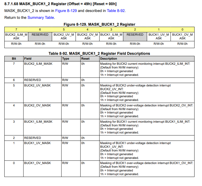

    Now to confirm, what can be done is to disable the VMON on the power resources is to MASK the possible interrupts:
    These are from the datasheet, please write 1 to the bits in BUCKn_UV_MASK on BUCK1, BUCK3, BUCK4
