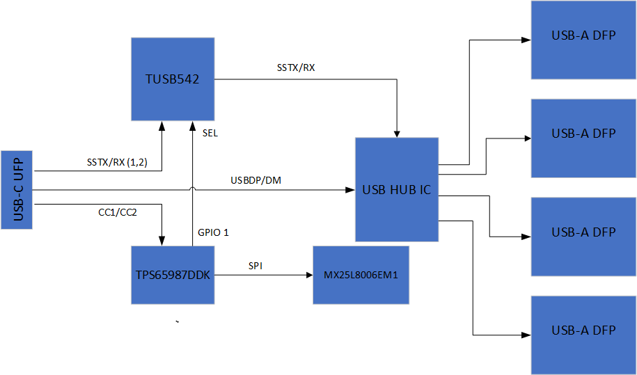

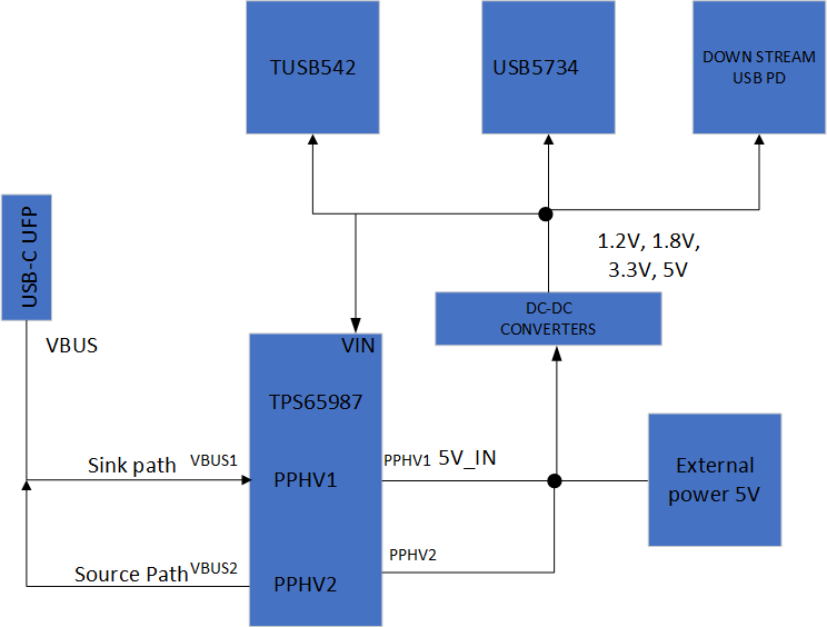

I want to configure my TPS65987DDK PD controller using application customization tool but I've never use it. I've used the TPS65987DDK in my USB HUB project and it will be in DRP mode will have power swap ability. Which parameters should I change? what are your suggestions?
