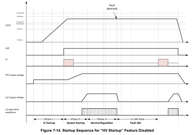

    Datasheet 33page "Figure 7-14" shows the sequence in which VCCP is supplied, 5VP and LL are output, PFC is operated, and LLC is operated.
    Isn't this a problem caused by not following this sequence?

    In regards to figure 7-14.  The systems engineer has designed this controller to power the LLC first and then the PFC.  Thanks for pointing that out.  I was not aware of that.  However, in designs that I have done, I have powered the PFC first and then the LLC.  This is because the LLC is limited to input range of 2 to 1.  However, it is possible to design for figure 7-14; as long as, the input voltage is less then 2 to 1.
