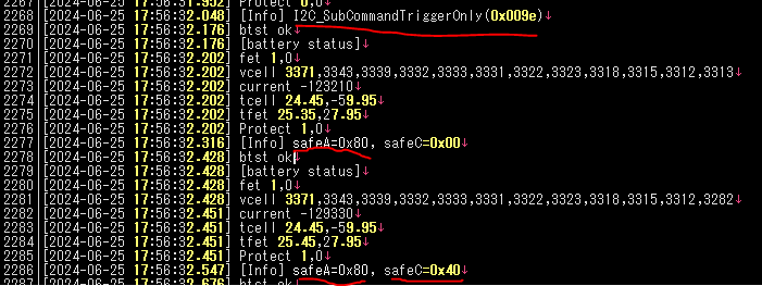

I want to recover from Short Circuit Lach Protection.
Please teach me Load detection.
If I read Safety StatusA(0x03) and  Safety StatusC(0x07) and set SCD or SCDL, I send LOAD DETECT_ON(0x009E).
If removed, are SCD and SCDL cleared?
Do I need any other settings?

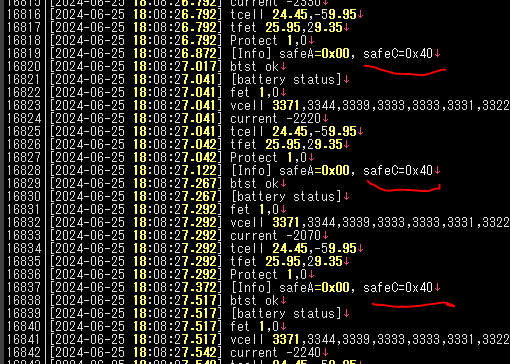

    It's still not working.
    CHG-FET remains ON, but is Load detect related?

    I send LOAD_DETECTION_ON() after the SCDK fault has trigger,
    but it's still not working.

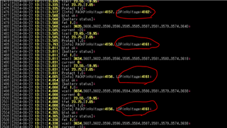

    I checked the LD voltage(Direct command 0x38) when the load was removed.
    I think the load detection worksd, because LD voltate is 4.0V or more.
    However, the load detection is not works.

    After testing on bench here was the results:
    If Load Detect: Active Time was not zero and the Load Detect: Retry Delay was zero, the SCDL fault would recover when the LD reached above 4V.
    If Load Detect: Active Time was zero and the Load Detect: Retry Delay was zero, then LOAD_DETECT_ON() was sent the LD pin would read above 4V. However, the SCDL fault would not recover (as you were seeing).
    To manually control the load detect you can set Load Detect: Active Time to zero and the Load Detect: Retry Delay to zero. Then when you send LOAD_DETECT_ON() you can read the LD pin voltage and if it is above 4V you can send SCDL_RECOVER() (recovering the fault manually).

    I understood that LOAD_DETECT_ON() command is for HOST to monitor Load PIN, and HOST must detect removal load and send SCDL_RECOVER command to release SCDL.
    What should be the LD PIN threshold for HOST to detect removal Load?
    3V or 4V?
  • Hello Takayama-san,
    This is up to you, you decide what voltage your host wants to send the SCDL_RECOVER() command. When the part recovers automatically it uses 4-V as the threshold.
