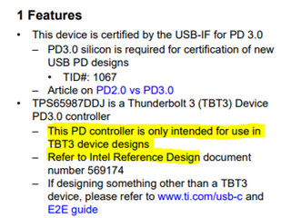

    Are you following a reference design? Typically we only support the TPS65987DDJ if a reference design is being used, otherwise it is expected to use the 987DH or DK which should be options in the GUI. If you don't select the correct part, that very likely could be why it isn't working. If you are not working on a reference design, you might need to switch to the DK as the DJ is not an option on the 6.1.4 GUI.

    The TPS65987DJ family is only really used and supported when used in specific reference designs for notebook or pc applications. If you are not familiar with these desings and not working in this application space, you shouldn't be using this part and instead be using the 987DH or DK. That is why the GUI only has the DH and DK variants as option.

    Yes, this can cause an issue. The devices are not exactly 1:1 so using the DDH image on DDJ hardware is not guaranteed to work.

    I think the main change that needs to be made is to switch over to the TPS65987DK so we can be confident it will work with the GUI. I also think you will need to use the SPI flash if you want to be able to configure the part through the GUI.

    I apologize if the device features and use case were not clear, but the TPS65987DDJ is intended for thunderbolt applications only. For TBT designs, we require that the customer is using an Intel Reference design.
    If you want access to the register map and GUI for the TPS65987DJ, you will have to request access through the link found on the TPS65987DJ product page. As mentioned before, we do require this is the TBT application and you are using a reference design, so if you do not have this information, your request will be rejected. This is the only way to get access to the documents for this device.
    https://www.ti.com/product/TPS65987DDJ
    As mentioned before, your best option is likely to switch over to the TPS65987DH or DK, which have register and GUI availability and do not require being using TBT or a reference design.
