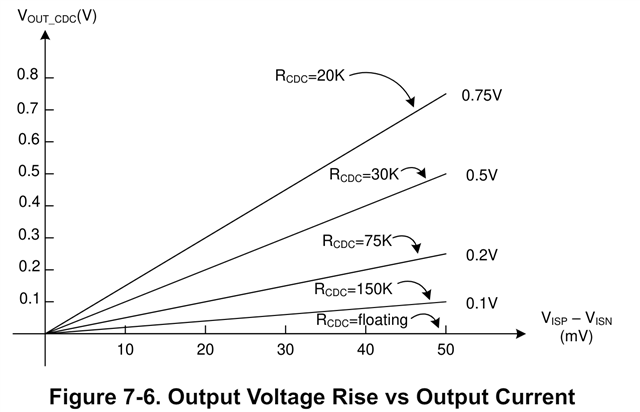

TPS552882: minimum RCDC that can be used
Part Number: TPS552882
The datasheet for the TPS552882 shows a figure for Cable Droop Compensation (CDC) that shows various plots for compensation for Rcdc=[20kOhm, floating].  I cannot find anywhere where the mininum RCDC is defined. What are the full limits of RCDC?
