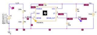

I tried simulating the TPS3897A Transient Model with PSpice for TI, but the output was not as expected. (No errors were displayed.)
Why doesn't the SENSE_OUT change even if the SENSE exceeds 500mV?

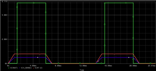

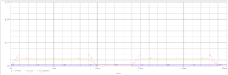

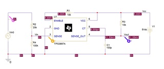

    I simulated the local library (CDS_SPB_HOME\CDSSETUP\PSPTILIBDIR\TPS3897A.lib) in PSpice for TI (23.1-2024 S001 Windows SPB 64-bit Edition),and then I simulated TPS3897A Unencrypted PSpice Transient Model Package (Rev. A) (SBVM073A) downloaded from www.ti.com/product/ja-jp/, but the results were the same. (See Schematic.jpg and Result.jpg)

    Thank you for your understanding! I noticed the model is working when there is a dc source that higher than the sense threshold voltage at the SENSE pin. I think best way to support you with this inquiry is providing a oscilloscope picture that shows the expected behavior of your design.

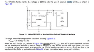

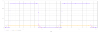

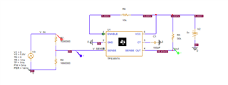

    I found the issue and it is not the model. Please increase the resistor divider (R2 an R4) at the Sense pin. Please find my simulation result and schematic in below.
    Please find the relevant information regarding resistor divider in the datasheet in section 8.3.1 Input Pin (SENSE).  The resistor values needs to be higher than 100k.

    I simulated the model based on your information
    and it seems to work only when V_IN=(1+R1/R2)*0.5,
    but not when V_IN>(1+R1/R2)*0.5.
    Does this behavior meet the specifications of this model?

    I want to let you know that I got the same reset behavior from the simulation. It seems like there is something wrong with the model, it is not fully showing the output behavior.  Our team is already start working on this. Once again, thanks for bringing that to our attention!

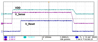

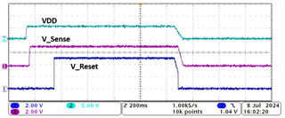

    I used the TPS3897A-6P-EVM047 evaluation module (EVM) to provide you the expected behavior.
     In the above oscilloscope picture, Vsense (3.2V) is applied to resistor divider so that the voltage at the SENSE pin is equal to 0.5V  ( there is no test point to monitor the voltage at the sense pin on the EVM board).  As you can see it here, the reset is asserted after the reset delay.
     In the above oscilloscope picture, Vsense (5V) is applied to resistor divider so that the voltage at the SENSE pin is equal to 0.8V and the reset is again asserted after the reset delay.
