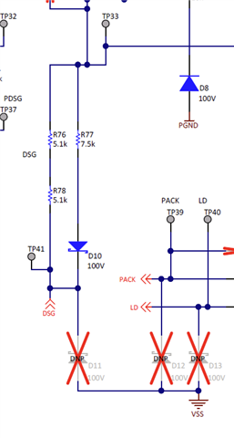

Hi:
How can i do with those pin are not using in final design?(No any external circuit need supply voltage)
1.REG2
2.REG1
3.REGIN
4.BREG
Can i just ground it of need a 100nF cap to ground for best EMC?
And like:
FUSE,DCHG,DFETOFFF,CFETOFF,HDQ,TSX
Will have EMC problem if that float?
I find there had 2 5.1K resistor in there,why need 2 5.1K?If i using multi FET can i reduce the value and using 1 resistor only?(Now is 12 fet with 51R on each gate)
And i see D11 is not using but i see it suggest on other datasheet,what is the using of this and should i keep it?
