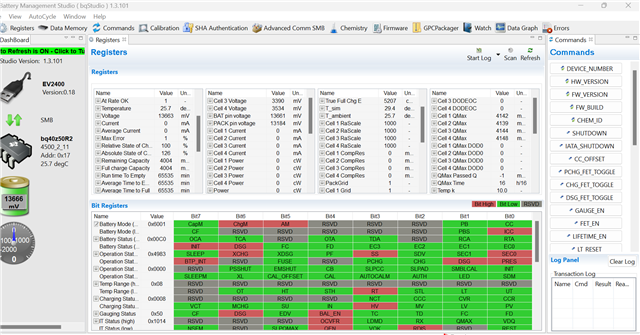

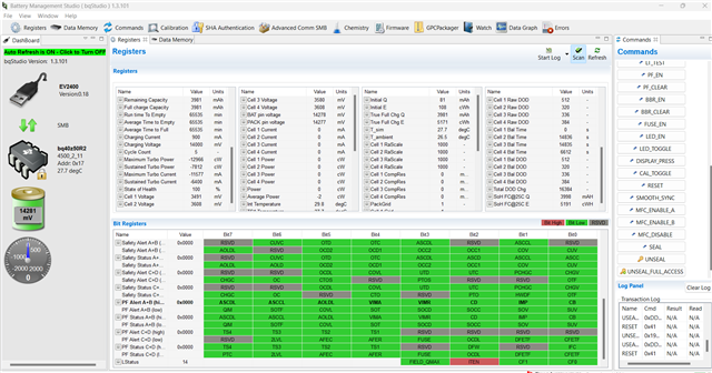

1.i was monitoring my battery charge sequence and and as per the gg file if RSOC is 100% or if any of the cell voltages reaches 3500mV then FC=1
this was not the case for my pack
battery has reached 100%,3500mv but FC flag is still not enabled?
if anyone can help that will be appreciated
2.What is meant by battery conditioning?
if this appears what does it indicate?

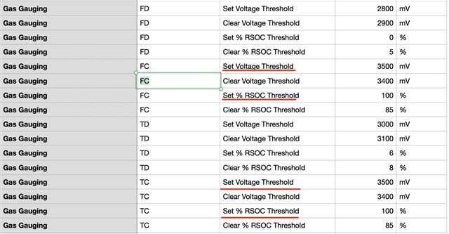

  • Hi Jonathan,
    The reason FC was not being set was because the gauge was configured to set FC bit based on the VCT conditions being met and not based on voltage of the cells.
    To fix this, set SOC Flag Config A [FCSetVCT] = 0 and set SOC Flag Config B [FCSetV] = 1.
    A learning cycle is the initial test that is run on the gauge so it can learn the Qmax and internal resistance of the battery. The process is outlined in this document:  https://www.tij.co.jp/jp/lit/an/slua903/slua903.pdf

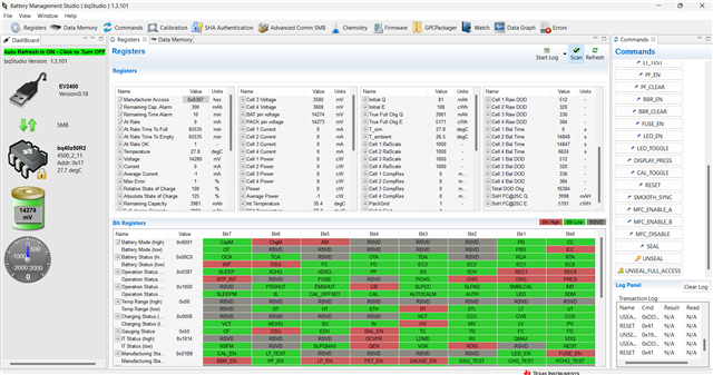

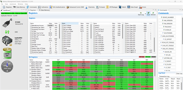

  • Hi Nick,
    I seen something abnormal with my Packs, some are setting VCT,FC,TC at 100% and some are not ,what can be the potential root cause of this or faults?
    See screenshot:
    gg file:00KA.gg.csv
    gg file:013T.gg.csv
    As you can see these two Packs are not behaving the same at 100%,i have attached gg files of both packs
    Jonathan Kabangu
  • Hello Jonathan,
    I checked the configuration and it is still configured to set FC bit based on VCT. Thus if VCT is set, then FC is also set.
    Nick Richards

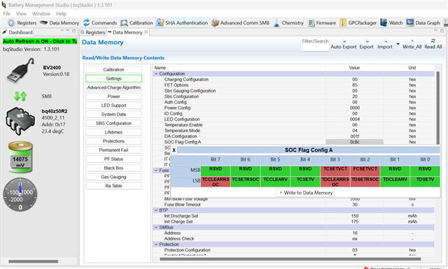

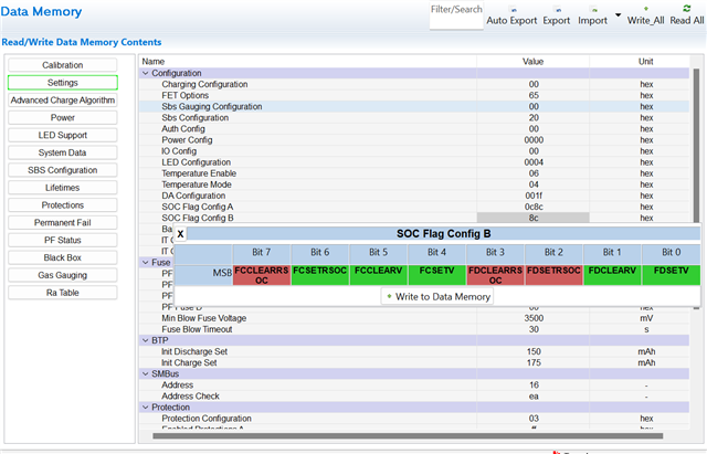

  • Hi Nick,
    Can you send me a screenshot of this configuration please cause i cannot find it within the gg file
    also since one of the packs sets VCT  and the other does not ,does it mean they have different settings then?
    if possible a screenshot of the two configuration to help me see this
    Jonathan Kabangu
  • Hello Jonathan,
    Here are the registers I am referring to.
    I can not determine why one set VCT and the other didn't without seeing a log file of the process that occurred.
    Nick Richards

  • Hey Jonathan,
    there's only option for SOC flag config A and SOC flag config B
    You have to click on the values for those registers to get access to change each bits as shown in your next screenshot. Red means 1 and green means 0.
    If you want more information regarding SOC flag config A and SOC flag config B, please refer to section 4.7 of the TRM.
    Regards.
    Nick

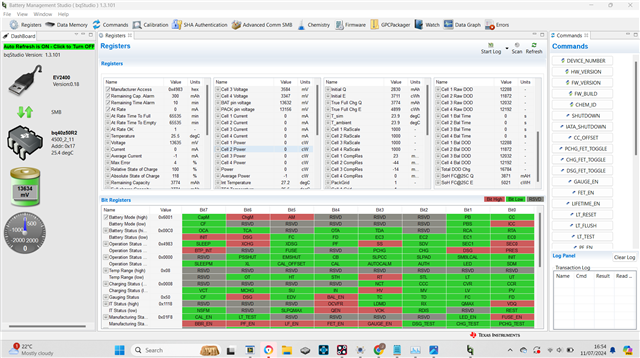

  • Hi Nick,
    I've unset TCSETVCT & FCSETVCT and the bit registers still shows VCT true at 100%
    See screenshot above ,VCT is still TRUE even after i made the condition FALSE,
    i've i missed anything ?
    Jonathan Kabangu
  • Hello Jonathan,
    The VCT bit you are referring to is not affect from those registers. Those affect TC and FC bits.
    Nick

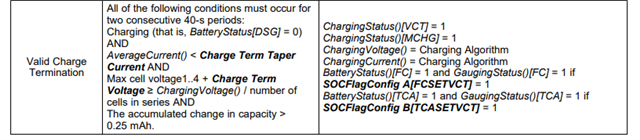

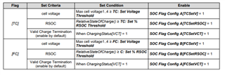

  • Hello Jonathan,
    I will share a screenshot about how Valid Charge Termination is determined.
    Charge Term Taper Current and Charge Term Voltage are the two registers that affect Valid Charge Termination. Can you also share the gg file?
    Nick

    • i've got one more with no VCT but in this one the current gradually goes below 300mA, please have a look at the logs and let me know the fault with this one ,the condition for VCT are :
    1. Battery Status DSG=0:this means the battery must be in a non charging mode, correct?
    2. average current > taper current :this means the charging current should be less than 300mA, correct?
    3. max cell voltage 1...4 + Charge term voltage > charging voltage, Can you please explain this one
    4. accumulated change in capacity >250 mAh : capacity should not change more than 250 mAh
    01NL.log
    i wonder what's the issue here as to why VCT did not show up ,
    Jonathan Kabangu
  • Hello Jonathan,
    No, this is stating that the gauge is in a charging mode.
    That is correct.
    Charge Term Voltage is just a parameter, I recommend keeping this at default value.
    This is stating that the passed charge should be greater than 250mAh
    The issue I see with the log file that at random occurrences, there will be a discharge current. This causes the Battery Status DSG bit to be set to 1 which is messing up the calculation for VCT, which is why VCT is not being set for you. You need to fix the charging method, so that during charge there isn't short instances of discharge current.
    Nick

  • Hi Nick,
    i've understood that VCT not being met is due to to the condition not being seen for 2 consecutive 40 seconds for it to be TRUE
    but how come the FC and TC bits are not set although being within the threshold set in our gg file (3500mV,100%)
    screenshot:
    logs:2477.01NL.log
    3460
    3621
    3589
    3619
    3460
    3621
    3588
    3619
    3460
    3621
    3589
    3618
    3461
    3621
    3589
    3619
    3461
    3621
    3589
    3619
    3461
    3622
    3589
    3618
    cells hitting 3500mV and RSOC is at 100%
    gg:4544.01NL.gg.csv
    Jonathan Kabangu
  • Hello Jonathan,
    I checked the gg file and because it is configured where FC and TC is set when VCT gets set. You need to change SOC Flag Config A and B to make sure it gets set based on voltage. I explained this in a previous response.
    Nick Richards
  • Hi Nick,
    Sure i was able to see this in BQstudio
    but in gg file all i see is this
    do these codes in hex mean VCT set by FC & TC?
    Jonathan Kabangu
  • Hello Jonathan,
    That is correct. That is hex code for the setting VCT by FC and TC.
    Nick Richards
