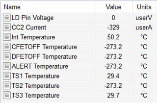

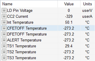

For example, if I enable TS3 for temperature monitoring using 18k Ohm pull-up resistor and 18k temperature model, the write operation is successful.
But in the register window, we see that TS3 temperature is still at -273°C which means that TS3 is still not enabled for measuring temperature.
Similarly we were able to edit the other data memory parameter's values but we  unable to get the expected results.

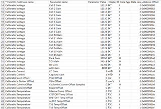

We exported the Gas Gauge Comma Separated File/ Golden Image file.
Find it here - bq76952.gg.csv
Take a look at the below screenshot of the same.
We noticed the address mismatch here.
Here until Calibration: V Divider Offset: Vdiv Offset, the addresses match with that in the data memory table provided in the TRM. From Calibration: Current Offset: Coulomb Counter Offset Samples, the addresses do not match with that in the data memory table provided in the TRM.
Settings: Configuration: TS3 Config  address is 0x92FF. From the exported file, the address 0x92FF is assigned to Settings: Interconnect Resistances: Cell 4 Interconnect.
The initial value for Cell 4 Interconnect's value is 00
When I change the Cell 4 Interconnect's value to 07, TS3 gets enabled.
Why is the address mismatch happening? Due to this issue, we are not able to configure BQ76952.
