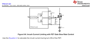

Hi Ling,
TPS1211-Q1 can do soft-start by adding RC network at the GATE (PU pin) as shown in Figure 8-6 in the data sheet. You can use large RC value to set long startup time while charging large Cout with lower inrush current.
Please use design calculator for calculating RC values.

Thanks for your reply
1. can you share me the design calculator for calculating RC values.

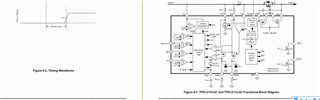

2. Can you provide Figure 8-6 directly? I do not find Figure 8-6 in datesheet. Only Figure 8-2

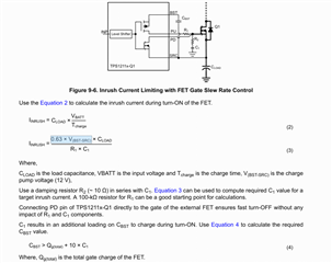

The tool only gives the value of C1 to set the target inrush current.
You can calculate (soft start time Tcharge) manually by using equations 2 and 3 in the data sheet

I want to know why Vbatt = 0.63 × V (BST-SRC)?
Thanks again~
as it is RC network with exponential rise-time, we have approximated with linear curve for 1 time constant. https://en.wikipedia.org/wiki/RC_time_constant
