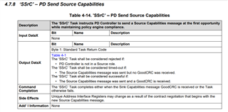

    7. Is there a case when the system is not using the battery to power the USB PD? The MCU can update the Transmit source capabilities register 0x32 and then send source capabilities (4CC command) to the far-end device.

    7. Yes, there is a situation where system use AC/DC psu instead of battery. I have on board Hot-swap circuit. So, I would like to source 100w (20v5A) when PSU sourcing power to board. When Hot-swap swap to battery input, I would like to limit max output power for usb pd to 60w (20v3A). This question number 7 is quite hard to understand for me because to this day, I didn't do any "deep" config for usb PD. So, for now this funcion with power limitation not have high priority. But Thank you for example how should I do it.
