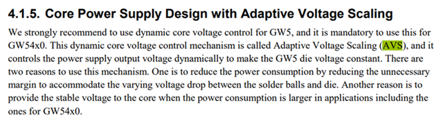

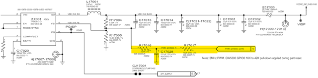

I want to check if TPS62813-Q1 can support AVS(Adaptive Voltage Scaling) or not.
As I know, AVS is using the external circuit to control the Vout. Not sure if it has any limitation or not?
Roy
