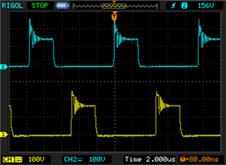

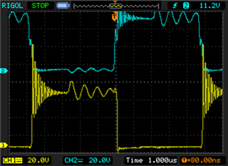

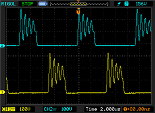

So far, I’ve been just trying to get it running at 60VDC in and very light output loads from 0 to 4amps.  The output voltage is correct at 48VDC but I’m concerned about some high voltage ringing on the secondary and quite low efficiency
The above scope shot is:
                CH1 = Q6-D-S, CH2 Q7-D-S (Output Fets).

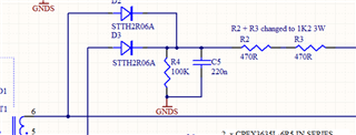

                The RCD snubber circuit is fitted, R2-R3 resistor replaced with 3W 1K2 resistor gets smoky hot after about 30sec.
                Vin is 60V @ 1.2A (72W) Vout is 47.7V into 47R load (48.4W) efficiency 67%.

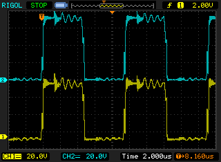

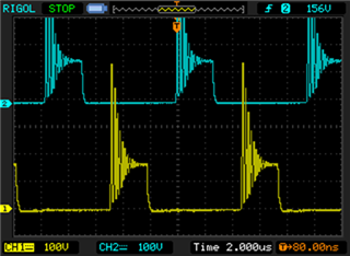

So, I tried removing the RCD snubber and this is what I got:
Very high ringing voltage spikes.  Vin is 60V @ 1.493A (89.6W) Vout 47.7V 47R load (48.4W) efficiency 54%.

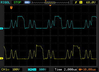

So, I decided to try adding an RC snubber directly across the Q6 Q7 fets D-S.  After much trial and error I came up with 5nF 0R39 RC.
Vin is 60V @ 1.2 (72W) Vout 47.7V 47R load (48.4W) efficiency 67%.
And ringing increases with increased load as shown below.
Vin is 60V @ 2.4 (144W) Vout 47.7V 23.5 load (96.8W) efficiency 67%.

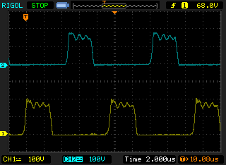

With both the RC snubber and the RCD snubbers fitted there is some more improvement in the ringing but efficiency goes down and the RCD snubber resistor heats up.
Vin 60V @ 1.424A (85.4W) Vout 47.7V 47R load (48.4W) efficiency 57%.
All of the above is with Q6, Q7 disabled with the gate tied to ground with 10R resistor, because at low power levels the synchronous fets are not operating and just the internal diodes are used.
As a test I tried replacing Q6, Q7 with diodes S3D50065D1.
Iin 985mA @ 60V (59.1W) Vout 47.7V 47R load (48.4W) efficiency 82%. So, efficiency is looking a lot better but I am not sure about ringing either side of main pulses.

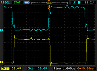

I also had ringing on the primary FETs Q3 and Q4.
Above is ringing on Q3.  I improved with 5nF 6R RC snubber across D-S as shown below.

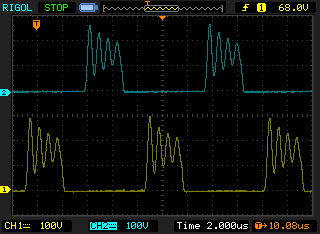

And this was ringing on Q4
Improved with 5nF 6R RC snubber as shown below.
So, my questions are:
Why all this ringing?  I don’t see RC snubbers being used on other UCC28951 circuits and evaluation boards.
Why is the RCD snubber as shown on WeBench design and evaluation boards consuming so much power?  Is this normal at such low output powers causing very poor efficiencies at light loads?
What should I be doing to progress this design to the higher output powers I need, not just 1-4 amps but up to around 90A.  I’m worried everything will just get worse as the powers increased.  I think the ringing is already causing interference with the control card and I had a lot of the UCC27524 gate drivers destroyed when it was connected to Q6 & Q7.

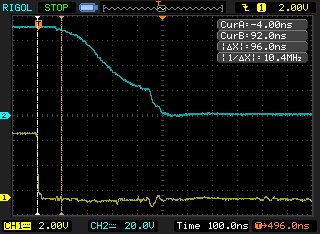

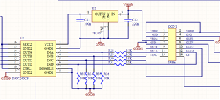

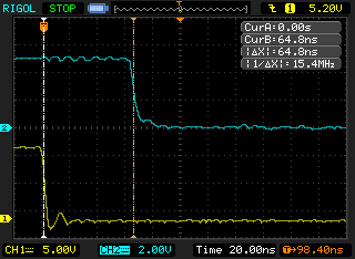

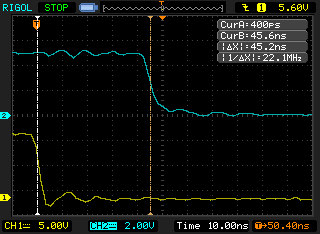

    Regarding the 200nS delay.  From IC signal to gate we have the 12V to 5V resistive divider, then the ISO7240CF isolator, then the UCC27714 gate driver.
    Measure delay through the resistive divider and ISO7240:
    Around 65nS.  I improved that a bit by dropping the R28, R36 resistive divider from 15K-10K to 1K5-1K0.
    So from 65ns to 45nS.  According to ISO7240CF datasheet that's around what is expected:

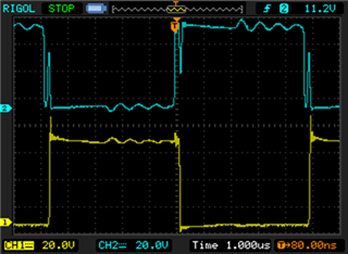

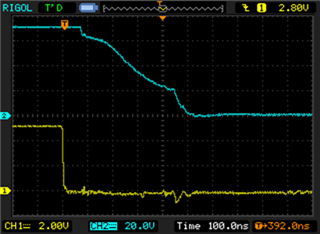

    Regarding the gate voltage ringing in middle of cycle:
    And from UCC27714 gate driver Pin 1 to Mosfet gate we have:
    About 96nS.  According to datasheet its 90-125nS so we're in the ballpark.
    96nS + 46nS = 142nS so it's in the ballpark.  Does this need to be improved?  I believe I found the ISO7240CF isolator UCC27714 gate driver solution from one of the TI app notes.

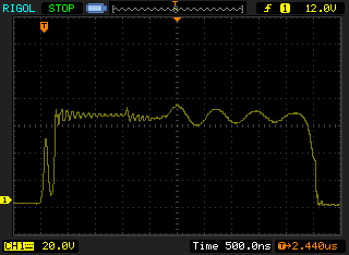

    Regarding the gate voltage ringing.  I don't think it is from signal path from IC to the FET gate, I think it is mirrored from what is on the source of the high side fet.  It is much worse until I added all the RC snubbers which is part of my original questions (why the need for all the snubbers in my circuit not seen on app notes).
    This is high side fet Q2 Ch1-S, Ch2-G with no snubbers-a lot worse.
    It lines up with the turn off of opposite high side fet.
    Ch1 Q1S Ch2 Q2-G.
    The SR side is not switching, this is very light load 1A so I am not expecting any switching at these light load because CS is below DCM threshold.

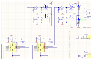

    I think you misunderstand, as per my circuit diagram I am not using a divider to drive the fet.  the divider I was referring to is between the UCC28951 (which runs on 12VDC on the isolated secondary and the ISO7240CF isolator which runs on 5VDC.
    The FETS are driven from the UCC27714D via 3R0 gate resistor and 10K pull down resistor.
    So, if it's slow I don't understand why, I'll investigate more in the morning.
    FYI, here is my schematic which should have been included in my original post.

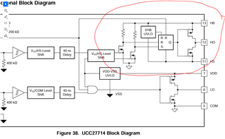

  • Thanks for the clarification.
    The waveform of the isolator output to the HB driver input (CH2) is fairly clean.
    From the input of the HB driver to Vgs, there is a big difference.
    I suggest you to focus on the circuit below.  The Ciss is 15nF, R5 is 3 ohm. The time constant alone is 45ns. You may want to reduce R5.
    Noise may be a separate issue and it is better to have at least 4 probes to debug it.

    Today I checked everything around the UCC27714 and I think everything is behaving as expected.
    If you look closely at the signal below:
    Ch1 is UCC27714D - Pin 1 Input.  Ch 2 is UCC27714D Pin 12 - Output to high side fet gate.
    It looks like really slow fall time right?  But actually the UCC27714D signal does not switch to ground to turn the high side mosfet off, it just needs to switch Mosfet VGS to zero volts (see below).
    It switches HO to HS, not to ground volts.
    So I think the high side mosfet is actually switched off within 100nS of the UCC27714D input going low.  You can see the little step in the blue trace above.  100ns is actually in spec for the propagation delay UCC27714D tPDHL.
    So although the negative edge of the gate waveform looks slow in this view I don't think it's bad in reality.
    If it were then the difference signal here driving the transformer would not be correct.
    Unless you have more things you want me to try, can you advise if we can progress this to some live discussion with experts to analyze my design as you suggested earlier?
    Dean.

  • Hello Dean,
    I am taken this over from Ning.  I reviewed your original questions and it looks like you are concerned about the ringing on the ringing on the SR FETs.
    1.  You can snub the ringing across the SRs with and RC snubber directly across them.  The following link will bring you to an application note that has a section on how to setup an RC snubber across output rectifiers.  I know the application note is written for flyback converters.  However, the calculations for setting up a snubber across a secondary rectifier are very similar to that of a PSFB converter.
    https://www.ti.com/lit/an/sluaac5/sluaac5.pdf

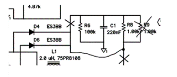

    2.  If you are concerned with the level of the voltage spike across the SR.  You might consider using a traditional RCD clamp.  The following thread discusses how set this up.   The EVM and the excel tool use a special clamp that was used to try to recovery the leakage energy.  I found the RCD clamp to be easier to use and more efficient.  The following thread discusses this as well.
    https://e2e.ti.com/support/power-management-group/power-management/f/power-management-forum/1132532/ucc28950-ucc28950-senkron-rectf-snubber-question
    3. One last thing you also want to make sure the SRs turnoff before inductor critical conduction.  You need to do this to prevent negative current going through the FETs and causing excessive voltage spikes at FET turnoff.  This can be done by properly setting up the DCM comparator.
    The following link will bring you to an application note that goes through the step by step design process of a PSFB using the UCC28951.  There is a section on how to setup the DCM comparator.
    https://www.ti.com/lit/pdf/slua560
    Mike

    Yes, I was/am concerned about the ringing on the SR FETs at light loads which increases as the load is increased and was causing excessive heating of the RCD resistor.
    This is the ringing seen on the SR Fets with no RC snubbers and no RCD snubber.
    Ch1 – Q7D-S, Ch2 – Q8D-S.  Vout is 47.7V @ 4A, Vin is 60V.
    So, as per your suggestion (1) I added RC snubbers directly across the SR’s Q7 & Q8. After lots of trial and error I came up with 5nF + 0R39.
    Still significant ringing but amplitude and frequency much reduced. Is this typical or acceptable?  That's about the best I could get it.
    Keep in mind I am only testing at very light load of 4A, so even well below DCM threshold of 30% maximum load.  So the SR are not switching yet, it is only using the body diodes of the FETs.  I’m hoping to get to maximum load of around 90A.
    I then tried your suggestion (2) of RCD snubber.
    First calculated resistor using formula from…
    R8 = VDSmax * 0.8 – VD6 – VoutX2/IL1 Max.
    Vds Max for IPW60R041P6 is 600V IoutMax IL1Max is 90A.
    600V * 0.8 – 0.8V – 48V*2/90A
    480V – 0.8V – 96V/90A
    383.4V/90A = 4.26 Ohm.
    I tried that in this configuration (without using the 5nF + 0R39 RC snubber) with R8=5R6:
    Didn’t seem to have any effect, did I calculate things correctly?

    I was also experiencing high voltage ringing on the primary side FETs as well.
    Ch1 – Q3 D-S.  Ch2 Q4-D-S.
    I found adding extra bulk capacitance across the rail closer to the fets improved this significantly.
    But I’m getting the double switching on the lagging side.  I checked everything on that side with the UCC27714D Hi-Lo side fet drivers but everything looked ok.  Can you advise what might be causing that double switching on the blue trace?
    I added R-C snubbers across all four primary fets. 1R0-10nF across low side fets, 5nf 6R0 across high side fets.
    Some improvement but double switch on lagging side (blue channel) still evident.
    > This waveform looks like you added too much capacitance.  This slowed down the ring frequency (fr).
    > fr = 1/(2*3.14*(L*C)^0.5)
    > The L in your high frequency ringing from the first wave form is most likely the transformer leakage inductance + 10 nH/in trace inductance.
    > You solve the fr equation for C.
    When setting the snubber you set the snubber resistor (Rs) first to dampen the ringing.  You set Q in the following equation to 1 and solve for C.
    > Rs =(1/Q)*(L/C)^0.5
    > Once you have R for the snubber you set the snubber C (Cs).
    > Cs = (0.02/fsw)*1/(3*R)
    >Increasing R should dampen the ringing amplitude.
    >Your layout traces may be too long.   Consider changing the layout and shortening the trace length.
    > This is an RCD clamp and only will clamp the peak amplitude of the ring.  It is will not dampen the ring frequency.
    > To reduce the heating of the the clamp resistor the more traditional RCD clamp was recommended.
    I also tried the original snubber configuration:
    The resistor R2+R3 1K2 3W gets very hot:
    >It was found that the RCD with R3 tied to the output will get hot because this resistor conducts for a long time.
    >This why I suggested the more traditional clamp.  The thread previously mentioned has calculations for setting this up.
    So, it is/was effective in reducing the ringing but R3 gets unacceptably hot and efficiency greatly reduced.
    Regarding your suggestion (3), as I mentioned above, load is currently well below DCM threshold so SR fets not triggered yet.
    >This is good.  So there is not reverse current in the FETs.  This will protect them in the design.
    > Your trace length in your design may be considerably long.  Consider relaying out the boards and shortening the traces.  10 nH of inductance is added for every inch of trace.
    > There are recommendations in the UCC28951 data sheet for layout that you might find helpful in section 10 of the data sheet.
    > The following link will bring you to a 300 W reference design that was designed to use the UCC28950 and UCC28951 in a phase shifted full bridge.  There is a schematic, layout and test data in the user's guide at this link.  You might want to study the layout it may give you ideas on how to improve your layout and reduce ringing in your design.
    https://www.ti.com/lit/ug/sluub02a/sluub02a.pdf
    >I believe you are talking about the resonant ring of the switch node.  I have circled it below.
    >To fix this you just need to adjust RDELAB/CD to turn on the FETs to valley switch.
    >The following link will bring you to an application note that goes through the step by step design process of the UCC28951 in a phase shifted full bridge.  It gives recommendations on how to setup the timing the turn on delays to give valley switching at light loads.
    I also noticed output voltage is just starting to drop out with light load of 4A output drops from 47.8V to 46V.  That is with 60V input so that’s worrying me as well because webench circuit I based my design on was down to 55V input.
    >If the output is dropping out it may be going into and over current fault due to noise on the CS pin.  You might want to check that.
    So that’s where I’m at so far.  Unless you have more suggestions/comments I now intend to test with increased input voltage and output current.  That requires changing from bench PSU to batteries.
    Any assistance at all you can provide would be greatly appreciated.
    It seems like Webench has given you a functioning designing.  There just seems to be lots of issues with ringing and noise  causing circuit misbehavior.  This most likely is due to layout issues.  Also there is a lot of questions to what the functional waveforms should look like.  I would suggest ordering the 600 W evaluation module, UCC27714EVM-551, so you have a known good phase shifted full bridge (PSFB) design to compare waveforms and layout to your design.  This information should help in the debugging process and fixing any layout issues.
    The following link will bring you to the user's guide for the UCC27714EVM-551.  The UCC27714EVM-551 is a 600 W phase shifted full bridge (PSFB) reference design that was design to use either the UCC28950 or UCC28951.  There is a schematic, layout and critical waveforms in this user's guide.  You can order this evaluation module from ti.com
