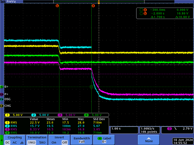

My customer is testing CUV protection with BQ40Z50-R2.
The CUV Threshold set to 2700 mV, with 1s CUV delay.
But the DFET is only turned off when the cell voltage is below the CUV threshold for 1.7s.
What are the possible reasons for this 700ms delay?
