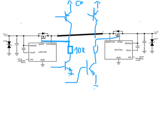

In my application I need to quickly disable the external FET in case of overload. Can I use an external bipolar transistor to short circuit the LM74700-Q1 GATE PIN to Ground (over an 10 Ohm Resistor) in case overload is detected? Will this damage the device?
Or alternatively how much delay I have form setting the EN to zero until FET OFF? This must be under 10us.

    I have a back to back configuration and am planing to use 2X LM74700 because I need the ideal diode in both directions. I want to use external circuitry to override the gate voltages. I need 4 states: All ON, diode direction A, diode direction B and all OFF.
    Will I damage the device if I use a transistors to short the gate signals?
    Here a simplified diagram
  • Hi Stefan,
    Grounding the GATE pin is not recommended. If you want faster turn-on, better to short it to ANODE as the GATE is driven with respect to ANODE pin and not ground.
    Next, I am not sure if 2 back-to-back LM74700-Q1 are going to work as reverse current blocking can NOT be disabled.
