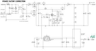

The circuit is a half bridge circuit driven by a UCC21550BQDWRQ1 isolated gate driver to drive an ultrasonic transducer load 60W, 40kHz. The circuit has a PFC UCC28056BDBVT. Attached are the schematics and PCB layout. There is no rectifier needed as a sine wave is required at the output to drive the ultrasonic load. The filter consist of a single LC network.
The primary concern is the half bridge circuit.
The test with no load (no transformer connected as the relay is OFF):
  • The UCC21550BQDWRQ1 input PWM was supplied by UCC28086DR.
  • The low power side was supplied by 5V DC
  • The Isolated side of UCC21550 by external regulated power supply of 13.5V DC
  • The PWM output both on the INA, INB (5V, 0V) and OUTA and OUTB (13V 0V) showed the expected voltage values.
  • The Input power was initially 385V DC, the PFC output and it was working fine.  The Bulk capacitor is charged up to the input voltage before turning ON the UCC21550.
  • The circuit have two inrush current limiters. 1) after the common mode choke and at the output of the PFC circuit.
Issue:
  1. The 2A fuse close to the Bulk capacitor of the half bridge circuit was connected in order to supply the PFC output voltage of 385V DC to the Input of the Half bridge circuit.
  2. Upon activating the UCC21550 IC, the 3A fuse connected to the input power supply from the mains blew, damaging the sense resistors of the PFC UCC8056 circuit and the VCC power to the PFC.  Both the PFC UCC28056BDBVT and the UCC21550 IC shared the same external power supply. But the 2A fuse connected before the Bulk capacitor of the half bridge circuit was unaffected.   Only the PFC UCC28056B was affected.
  3.
  4. The PFC UCC28056B circuit was remove from the board. The UCC21550 circuit INA, INB and output A and B was tested without input power supply, and it worked fine as expected.
  5. Since, the PFC UCC28056 circuit was removed, the input power 332V DC (240VDC without load) is then supplied directly to the half bridge.
  6. Upon activating the UCC21550 IC, the 2A fuse connected before the Bulk capacitor of the half bridge circuit blew immediately but the replace 3A fuse from the mains did not blow up.
  7. The Drain and source of both the high side and low side MOSFET of the half bridge  were shorted, indicating that the MOSFET is damaged. The MOSFET was tested before being mounted on the PCB.
Question:
  1. What could have gone wrong with the half bridge design?

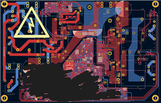

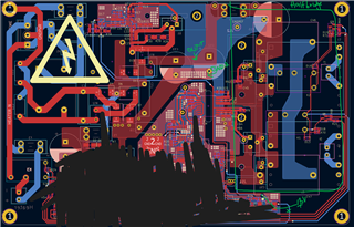

  2. Kindly review the schematic, especially the PCB layout  and give a definitive reason why it may have failed. I can send the source file (kicad) on a private chat.
Kind regards
Bright

  • Hi Bright,
    Your schematic and layout pertaining to the gate driver portion both appear to be designed properly. To better help discover any potential root causes that may be resulting from the gate driver, do you mind sharing any test waveforms you may have saved or are able to replicate when running these tests? This may help to indicate what exactly is causing each of the fuses to blow.
    Will

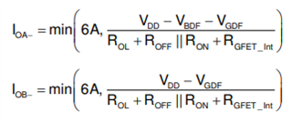

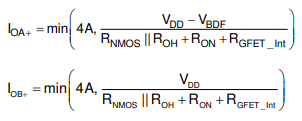

  • Hi Bright,
    1. The output current of your gate drive will be calculated with the above equations, where I_OA+ is the output source current at channel A, and I_OA- is the output sink current at channel A. If your calculations do not exceed the ratings of your fuses, then the output current of the gate driver is not responsible for the fuses blowing.
    2. In terms of deadtime, make sure you have calculated the right deadtime necessary to ensure there will not be a short when the other channel is turned on. This will depend on the specs of the components used in your output power stage. Then once you have a minimum deadtime value needed, use the following equation to calculate the necessary resistor value to produce that minimum deadtime value:
    tDT (in ns) = 8.6 * RDT (in kΩ)  +  13
    In this equation, do take note of what each variable's units are. The resistor value you calculate should be within the range 1.7kΩ - 100kΩ.

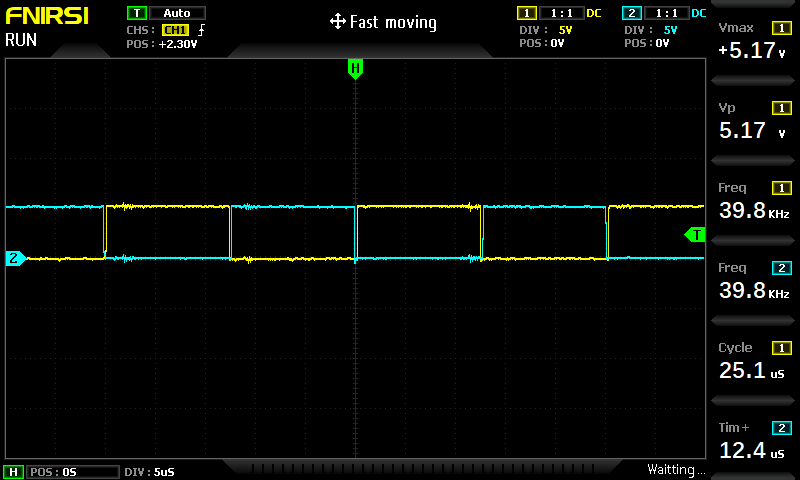

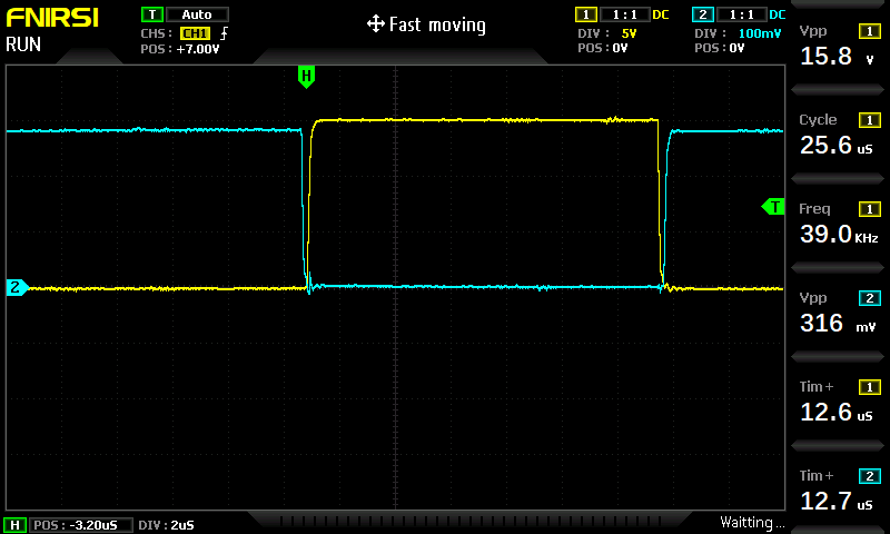

  • Hi Will,
    Apparently I forgot that the OUTA requires at least the Lowside MOSEFT to be connected for it to turn ON/OFF using the Bootstrap capacitor that will charge through the lowside MOSFET when turned ON (connected to ground)Sob
    DT = 20k, Gate resistor 10 ohm, VDDA and B,14V
    Waveform is attached below.
    1) From the waveform, do you reckon 200ns deadtime gives a sufficient margin to prevent shoot through while keeping the circuit functioning efficiently?
    2) or should I used DT 50k, 440ns?

  • Hi Bright,
    I hope your weekend went well. I'm glad you were able to figure out the issue regarding OUTA!
    Your dead time configuration appears to be sufficient. Programming dead time to be twice as long as what you currently have will certainly prevent shoot through, but it will result in a notable decrease in efficiency. I would definitely recommend taking multiple samples of data, to get a better understanding of the "worst case" in terms of potential shoot through. If your configuration gives enough time to prevent shoot through in the "worst case," it will be good for your application.

  • Hi Will,
    I am gradually increasing the DC link voltage by 5V, at 50V DC, the High side MOSFET temperature is 30 deg Celsius, while the Low side MOSFET (mounted on heatsink) is getting really hot, upto 70 deg Celsius, even with fan cooling, it was still rising beyon 70 degree.
    VDDA and B is 12.7V, gate resistor 10 ohm
    1) What could be the cause?
    2) Does it have to do with the PCB layout? I have previous attached it in our conversation.
    Kind regards,
    Bright
  • Hi Bright,
    I would first check to make sure the MOSFET is not faulty or being pushed past its limits stated in the datasheet. Then once validated, would you mind sending any waveforms you have of the voltages and current for each MOSFET, as this can potentially help to determine the root cause of any heat generation.
    Will

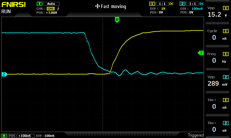

  • Hi Will,
    Thank you for your response, I have attached the waveform below. Let me know if its clear enough. The MOSFET is 800V, SIHP24N80AE-GE3
    Highside is blue coloured x50 probe
    Lowside is yellow coloured x10 probe.

  • Hi WIll,
    From the waveform above, I suspect cross-conduction risk (shoot-through) due to the partial overlap of the voltage across the Highside and the Lowside MOSFET, and led to increased current flowing through the MOSFET, implying high power dissipation.
    The PSU current limit was set to 430mA. At 40V DC, the current draw was 30mA, it showed a cleaner waveform. But when it was increase to 50V DC, the current draw reached the set limit of 430mA, the voltage on the PSU dropped to 46VDC and current 430mA. The lowside MOSFET temperature immediately spike up beyond 70 deg Cel and was increasing before I deenergised the circuit.
    I suspect the risk of cross conduction  is heating up the Low side MOSFET and the overlap, due to the increased resistance at the drain-source when operating in its linear region (partially turned).
    1) What do you think?
    2) How can it be rectified?
    Kind regards,
    Bright
  • Hi Bright,
    It appears that there could potentially be shoot-through involved. Increasing the dead time could fix this issue. Let me know if your system continues this behavior after increasing the dead time.
