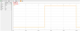

  • Hi Rakesh,
    Above is the schematic. Ignore the comments about the 12.5mΩ current sense resistor and 51kΩ OCP resistor, these values have not been changed. The board is configured for the 5A trip setting.
    This is the input waveform into the INP/ test point, a 10Hz 50% duty 0-4V square wave.
    This waveform shows the Vout in orange and the fault test point in blue.
    The board is driving only a 51Ω power resistor. I did not capture power path current, but it can be extrapolated from the Vout. I am shorting the directly across the output of the EVM using an insulated screwdriver. For this capture, the screwdriver was shorted and held against the terminals for a sustained short, and continuous arcing was visible from the terminal to the screwdriver.
    For my 100% duty cycle test, no connection was made to the INP/ testpoint, so the device is kept in 100% on by the built-in input pullup. In this case, the output was shorted by a 5V TVS diode, and the orange Vout and blue FLT traces can be seen to quickly decay.
