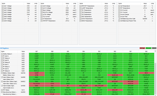

BQ76942: DCHG as Charge enable for BQ24610
Part Number: BQ76942
Other Parts Discussed in Thread: BQ24610,
Hello, we have a BQ76942 as a monitor chip and a BQ24610 as a charging chip. We want to use the DCHG signal to control the BQ24610 CE pin (Charge Enable) so that the BQ24610 is triggered when it is possible to charge. We have set 0x2A as DCHG Pin Config. However, charging does not start. (No safety / error flags are active).
With the DCHG pin config 0x29 the loading works (because this pin is then used as GPO and is high by default).
Attached is the config file. (in the file DCHG is still set as 0xAA) but this has been changed. All other settings still match.
DEVICE.gg.csv
