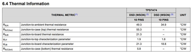

The customer reported that the measured case temperature of TPS7A74 is 90℃. If RθJC(top)=55.3℃/W is used, the junction temperature is about 124℃. Is this expected? In addition, can you share a guide, including how to test the case temperature, etc. Thanks.

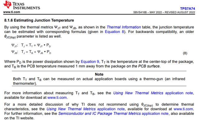

    Please see http://www.ti.com/lit/pdf/slup415 page 10, where psi parameters are discussed when testing the case temperature. If the customer is using a thermal camera or thermal couple to measure the top of the package, then the psi parameter "junction to top" should be used to estimate the bottom junction temperature.
    Additionally, how much power is being dissipated through the customer's device? This will determine what junction temperature to expect.

    The Pd is 0.62W.
    The customer places a heat sink on the IC, should the parameter ψJT still be used?
    In this case, would it be more reasonable to use Rθjc? Could you please confirm the value of RθJC? It is larger than Rθja. Is it reasonable?

    Thank you for your comments. I have a concern, why is the difference between RθJC and ψJT so big? If no heat sink is added and ψJT is used, Tj=0.62*1.9+90=90.2℃. It seems that it is recommended not to add a heat sink? Could you please reconfirm whether the values ​​of RθJC and ψJT are correct?

    "Small Psi parameter values are common for LDOs, as most of the internal integrated circuit is the pass device, which is dissipating the heat."
    Additionally, "Psi parameters provide an estimate of the junction temperature almost independent of the board layout."
    While RθJC is the die through the mold compound to the cold plate.
    RθJC and the psi parameter are acting as two completely different values due to the independence the dependence on board layout.
    You should add a heat sink, as you will have better thermal dissipation while using a heat sink.
    Especially if using the heat sink, I would recommend using 1.6 as the value for ψJT. The EVM should more closely relate the heat dissipation of the customer's board with a heat sink.
    Using the 55.3C for RθJC should work for this application. We do not have an exact value for RθJC with using the EVM, most likely because typically you would use RθJA.

    Please recommend which parameter should be used to estimate the junction temperature in this scenario (using a heat sink)? Is it ok to use Psi JT = 1.6? We see from the datasheet that the Psi parameter is used.
    Hailiang
  • Hi Hailang,
    I misspoke. Please see Using New Thermal Metrics (ti.com) to learn why TI does not recommend using  RθJC. We typically recommend using  RθJA parameter, so you should use the 34.9 C/W parameter to estimate what the junction temperature. If using the Psi JT parameter to estimate junction temperature, then yes use the 1.6 value.
