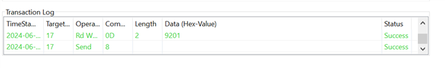

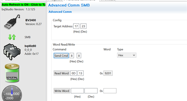

Tried to exit ROM mode but also failed... sent 0x08 cmd, the result is success but still in ROM mode

1. 0x08 did not make gauge exit ROM mode.

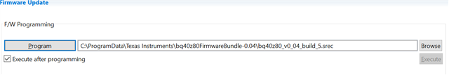

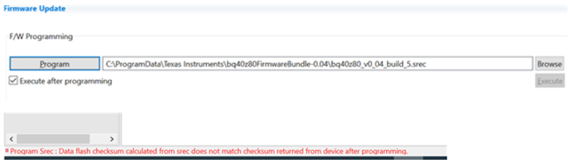

2. Checksum is not matched during program official FW.

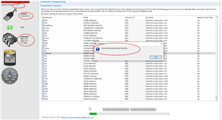

I was able to program the chemistry without encountering these issues. Make sure the bqz version matches the one given in the screenshot below.
You can use this link to download the latest bqz and srec file.
https://www.ti.com/tool/download/SLUC672

I can sure I am using the latest bqz. But when I tried to program the latest FW,
1. it failed with DF checksum error, it was very odd..
2. And the 0x08 cannot exit ROM mode. The device got stuck.
