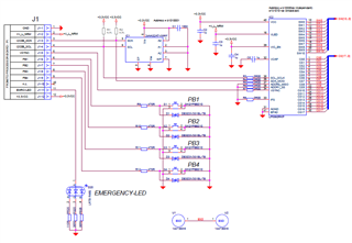

We are using the LP5860 component in our current project and have assembled a PCB accordingly. Unfortunately, we are experiencing an issue where the PCB produces an audible noise, and we are unable to identify the source.
We have already taken the following measures:
Replaced all ceramic capacitors with tantalum capacitors.
Increased the internal frequency from 62.5 kHz to 125 kHz, which shifted the audible noise to a higher frequency.
The PCB is powered using a lab power supply.
Despite these changes, the issue persists. Could you please assist us in identifying and resolving the cause of this audible noise?
We would greatly appreciate your support in this matter.
  • Hi Harry,
    Can you make sure the source of this noise is from LP5860? Or can you please help to show me your schematic?
    BR, Jared
  • Hi Jared,
    thank you for your feedback. We can confirm that the audible noise is coming from the Frontpanel Board. Our process is as follows:
        We program the chip.
        We then disconnect the Frontpanel Board from the Processor Board.
        The audible noise remains on the Frontpanel Board even after disconnection.
    However, the audible occurs only at certain brightness levels, not all.
    BR, Harry
  • Hi Harry,
    Can you please tell me the current register configuration of LP5860, such as the scan line number, PWM duty cycle?
    BR, Jared
  • Hi Jared,
    Registers Configuration:
    Dev_initial: 0x5B // Max_Line_Num (1011), Data_Ref_Mode = Mode2 (01), PWM_Fre = 62.5kHz (1)
    Dev_config1: 0x07 // SW_BLK (0), PWM_Scale_Mode (1), PWM_Phase_Shift (1), CS_ON_Shift (1)
    Dev_config2: 0xFE // Comp_Group3 (11), Comp_Group2 (11), Comp_Group1 (11), LOD rem (1), LSD rem (0)
    Dev_config3: 0xFF // Down_Deghost (11), Up_Deghost (11), Maximum_Current = 50mA (111), Up_Deghost_enable (1)
    Color current = 100%
    Dot current = 100%
    PWM global = 100%
    PWM individual = 100%
    PWM group = 2 groups are defined. The maximum audible noise seems to be when one group is set to maximum (100%) and the other group to a value different than 100% (about 70%). If both groups have the same value, there is no noise.
    BR, Harry
