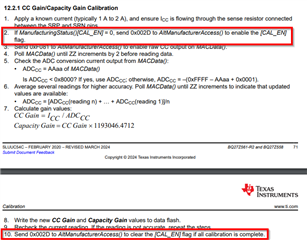

Device must enter calibration mode before start of calibration procedure and exit after write to flash...
These steps are not in the documentation.
Johnny,
Thats for CC Gain/Capacity Gain. It doesn't mention it for Temperature calibration. I'm doing free error checking on your documentation...I'm telling you its wrong or unclear in spots, why is TI fighting me on this?
