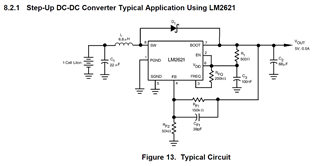

Set up the sample circuit breadboard style from the datasheet (Figure 13). All components used were following the schematic aside from RF1 and RF2 (100K and 22.2K).

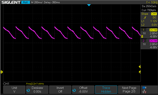

Also noted that when the enable pin is set to high, the sawtooth signal is slow until a load is present. Am curious if this is expected behavior. Please see attached image.

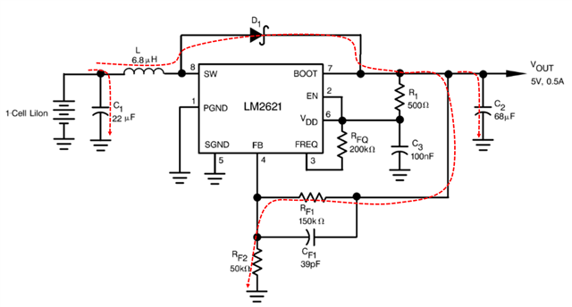

  • Hi Jimmy,
    In your setup, there will be additional leakages from the path of inductor --> diode --> RF1 --> RF2 --> GND (the major part) and from the input and output capacitors. These leakage are not counted in the max 2.5μA leakage in datasheet.
    What's the sawtooth signal? Vout? And what's the voltage for each div in the picture?

    For the signal output the max and minimum Vout on the sawtooth signal is 9.4V and 7V with a 2V per div. For the time, it is a 200ms per division.

  • Hi Jimmy,
    how to decrease the leakage current from those components
    The leakage from the path of inductor --> diode --> RF1 --> RF2 --> GND is decided by the topology. The only way of reducing this leakage is to increase the RF1 and RF2 simultaneously, for example, RF2 = 100kΩ and RF1 = 300kΩ. Please note that if RF1 and RF2 are too large, the Vout DC accuracy may decrease slightly. And also, as the RF1 increases, please decrease the CF1 proportionally to make the RF1*CF1 as constant.
    This is abnormal. The Vout should be very stable without such a big ripple.
    Please check whether the 68μF output cap(C2) is correct. And what's the Iout during your measurement?

    Regarding the Vout, I have the enable pin connected to a 2pos switch. One position to GND and the other to Vin. I noticed that when the EN is connected to GND the Vout is equal to Vin. When EN is connected to 5V Vin, the Vout is the sawtooth signal shown in the image previously sent. However, when the EN pin is left floating the output is stable with minimum ripple.
    When the EN pin is connected to Pin 6 node like in the datasheet, I still receive a sawtooth signal but with a shorter tooth amplitude. Would you have an explanation for this?
    For C2 I am using the T495C686M016ATE250 (CAP TANT 68UF 20% 16V 2313.
    When measuring the signal, Iout is connected to a device that pulls just a few uA. When a higher load is presented the signal is more stable.

  • Hi Jimmy,
    It is normal. Because when the LM2621 is disabled, the Vout equals to the Vin if ignored the voltage drops on inductor and diode.
    It's quite abnormal. We can find out the reason here first then check your second question.
    Could you help double confirm that when the 2pos switch switches to 5V, is the voltage on EN pin a stable 5V?
