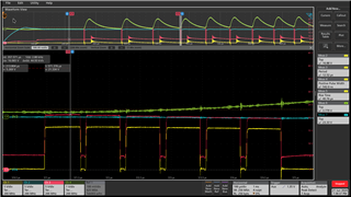

This problem is extremely urgent for my company. We are unable to build or product because the buck regulator circuit is not functional.

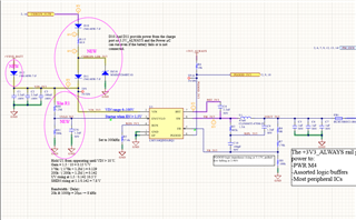

I have this circuit which worked in a pervious version of the design. The core of the design is unchanged but the buck regulator is not working properly.
The key symptom is the SW and BST not rising high enough during high-side switch on. The scope capture below is typical.
CH1: SW pin
CH2: Vin pin
CH3: BST pin
CH4: Vout, 3V3

    Please use a differential probe and measure the voltage difference between VIN and SW. Sometimes the probe DC offset causes the issue. Also, It will be helpful if you can share more waveforms (both zoom-in and zoom-out).
