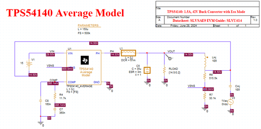

Hi team,
Our customer want to AC analysis by TPS54140 PSpice Average Model to Split-Rail topology.
They want to check Bode plot on setting value of result of calculate tools(SWIFTPOSNEG-CALC-v4).
Is it possible by this model?
Or are there other way of AC analysis in the case using this device as Split Rail topology circuit?

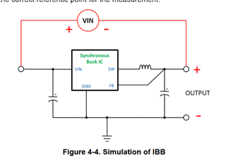

    When simulating inverting designs without a dedicated IBB model, please follow the recommendations in Section 4.4.3 of this application note: https://www.ti.com/lit/an/snva856b/snva856b.pdf

  • Hello Ridge-san,
    Thank you for the information. Please answer below question too.
    How I decided Cinj and Linj value?
    Is it okey that Output voltage setting resistance(R6, R7) is same value with Split-Rail circuit? These resistance is connected between positive output line and negative output line.
    teritama
  • Hi Teritama-san,
    In simulation you don't need to setup the same measurement network as in Figure 4-2 of the application note for an AC analysis. That is an example of using a network analyzer on the bench where you would need an injection resistor in the feedback path.
    The resistors for feedback are calculated the same as with the buck topology.
    Ridge
  • Hi Ridge-san,
    Thank you for reply.
    I set up like below figure for Vin=15V, Vout=±14.5V condition reference Application note Section 4.4.3 you shared.
    teritama

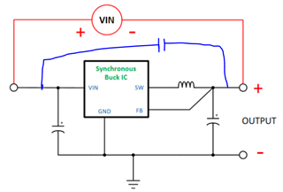

  • Hi Teritama-san,
    That looks like the correct setup. You may not need the Cinj and Linj for AC analysis.
    When you measure the output, make sure to use the differential probe and reference all of your measurements to the Vout node. Since Vout is now the system GND in IBB, you need to use that as the reference point so that you see the correct voltage values.
    Ridge

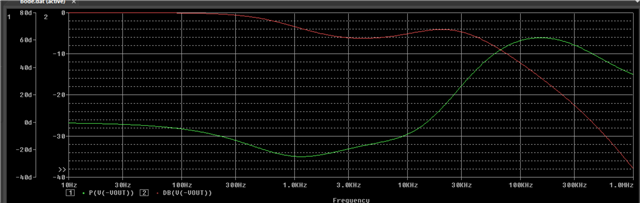

  • Hi Ridge-san,
    Thank you for your checking.
    ⇒In my understanding, Cinj and Linj is needed to inject the AC sweep signal. If don't use Cinj and Linj, how I connect Vac?
    ⇒This means like below plot. Right?
    teritama
  • Hi Teritama-san,
    I spoke to the team regarding your questions on AC analysis, and this model is not compatible with AC analysis. We do not have an AC PSPICE model for this device. To assess stability, the next best thing would be to perform a load transient test and check the output for a stable response.

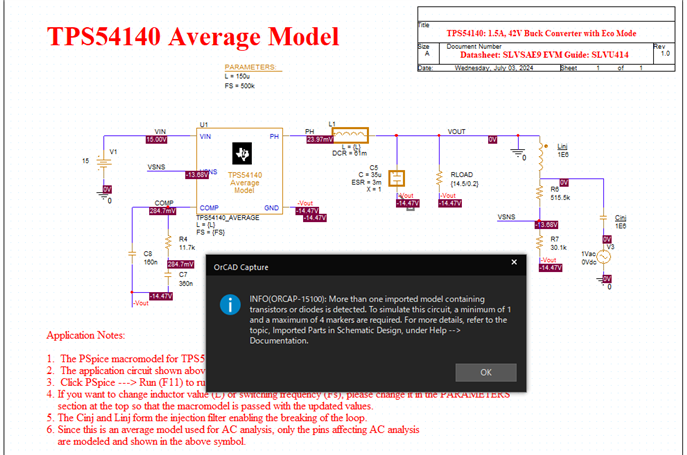

  • Hi Teritama-san,
    Here you can see the device correctly simulated a negative voltage, but I get some unintelligible data on the bode plot.
    It may be easier to simulate a load transient instead.
    Andrew
  • Hi Andrew-san,
    Thank you for your support. I tried your reference your schematic. But the simulation is failed by ERROR like below figure.
    Please tell me about reason of this ERROR?
    ⇒Does this mean recommend to use transient model and evaluate by transient response like the way suggested in this application note https://www.ti.com/lit/an/slva381b/slva381b.pdf ?
    teritama
  • Hi Teritama-san,
    On PSPICE for TI you need to place at least 1 marker in order for it to simulate.
    Yes, the app note you listed is good.
    Andrew
  • Hi Andrew-san,
    I used Bode plot - Dual Y axes. Is this marker not a pertinent marker?
    ⇒I understand, When evaluate IBB topology circuit. Is this okey that the simulation circuit follow the recommendations in Section 4.4.3 of this application note: https://www.ti.com/lit/an/snva856b/snva856b.pdf?
    I have a concern regarding Section 6 General Considerations in the application note.
    Are there some way of I know about the model internal GND?
    teritama
  • Hi Teritama-san
    Hmm maybe just put a couple of simple voltage marker on it. PSPICE for TI is a bit finicky.
    If I hook up the pspice like this I get errors, so I wouldn't recommend doing it like that.
    Andrew
