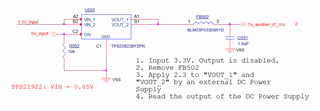

In addition to TPS22922BYZPR, I have 3 more alternative part in the BOM, which are TPS22924BYZPRB, TPS22964CYZPR and TPS22964CYZPT. It is up to the PCB assembly house which component to be used.
Now I have 2 PCBA which has different marking on. They are 44J5NF and 37Q3Z5. (The marking is so tiny. My reading might not be correct)
When the pin "ON' ="L" and 2.3V is applied to the pin "Vout", I saw difference between these 2. Please see below for detail.
Here is the detail condition.
1.) pin "Vin" = 3.3V, pin "ON" = 0.0V
2.) pin "Vout" is connected to the Vcc of another IC through a Murata ferrite bead BLM03PX330SN1D. (+ Vcc filtering caps)
3.) Vcc of this another IC has 2.3V on this pin even though the TI load switch is off. (because there is another voltage applied to this IC from another voltage path)
4.) I could see about 30mA total current consumption difference. Pin "Vout" of 44J5NF = 1.576V, pin "Vout" of 37Q3Z5 = 2.262V
5.) If I remove this ferrite bead, both current consumption becomes the same.
Could you explain why there is difference in between? I guess this is whether the load switch has the reverse current protection or not.
If so, does this damage the load switch if there is no reverse current protection?
