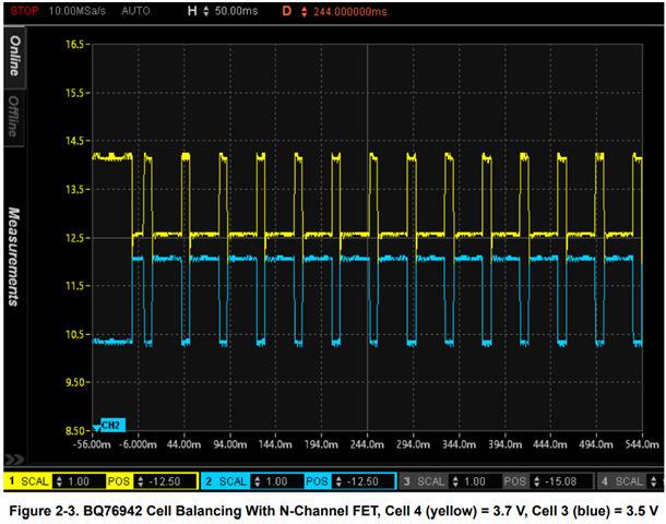

  • Hi John,
    Can you send a waveform of the voltage at the VC16 pin?
    The wave form of VC16 and VC3 should look similar to this if VC16 is balancing:
    Thomas Rainey

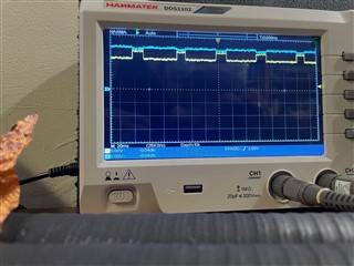

  • Hi Thomas,
    Attached is the scope shot.  I would think that maybe we should be looking at VC15 since that is the signal that drives the FET?   Yellow is VC3 and Blue is VC16. Let me know if you want other scope shots.
    Thanks!!!!
    John

  • HI Luis,
    Got a few minutes to look at this. Scoped out the VC1, 2, 3 and 16 pins on the board I have and they are all toggling. VC1 and VC2 are inverted to one another as are VC3 and VC6 so that matches the scope shot sent by Tom.  So looking at the schematic, I noticed that the two resistors aren't in parallel because CELL3 and CELL15 are NOT connected and I think they should be.  So I removed R154 and tied CELL15 to CELL3.  I can still read the cell voltages properly but in relaxed mode, I don't see Cell 16 being balanced. It keeps losing charge. It is at 3.506 (was at 3.521) but the other three cells are 3.711, 3.884 and 4.067.
    I also notice that the Cell Balancing Active Cell register is always at 0x0005. I've seen it at 0x8002 before as well as 0x0005. I have VCELL Mode set to 0x8007 and the Cell Balance Max Cells = 2.  I measured the voltage across R129 (CELL16 and VC16) and it is 0 volts meaning it is not balancing. But then I started to think,  there is no path to charge the top battery and since the top battery is lower in voltage than the other three then it won't balance.  It will only balance if it's voltage is higher than VC3 (I think!).
